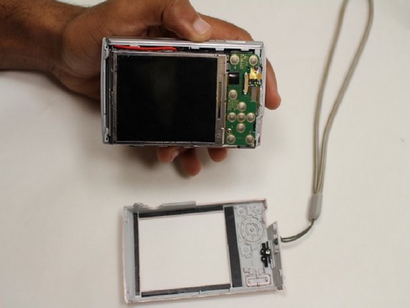

  3. Sony Cyber-shot DSC-W510 LCD Screen Replacement: crwdns2935265:03crwdnd2935265:01crwdnd2935265:02crwdne2935265:0 Sony Cyber-shot DSC-W510 LCD Screen Replacement: crwdns2935265:03crwdnd2935265:02crwdnd2935265:02crwdne2935265:0
    • Pry open the screen frame using a plastic opening tool.
    • It may be necessary to start by prying at one end of the screen and moving around the edge of the screen frame, until it pops out.

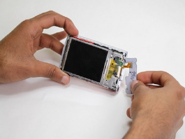

  4. Sony Cyber-shot DSC-W510 LCD Screen Replacement: crwdns2935265:04crwdnd2935265:01crwdnd2935265:02crwdne2935265:0 Sony Cyber-shot DSC-W510 LCD Screen Replacement: crwdns2935265:04crwdnd2935265:02crwdnd2935265:02crwdne2935265:0
    • Using the screw driver, unscrew the one screw on the control panel board.
  5. Sony Cyber-shot DSC-W510 LCD Screen Replacement: crwdns2935265:05crwdnd2935265:01crwdnd2935265:01crwdne2935265:0
    • Gently unplug the control panel from the motherboard outlet.
  6. Sony Cyber-shot DSC-W510 LCD Screen Replacement: crwdns2935265:06crwdnd2935265:01crwdnd2935265:02crwdne2935265:0 Sony Cyber-shot DSC-W510 LCD Screen Replacement: crwdns2935265:06crwdnd2935265:02crwdnd2935265:02crwdne2935265:0
    • Using your hands, pry open the LCD screen from the metal board.
    • Gently unplug the LCD screen from the motherboard.
