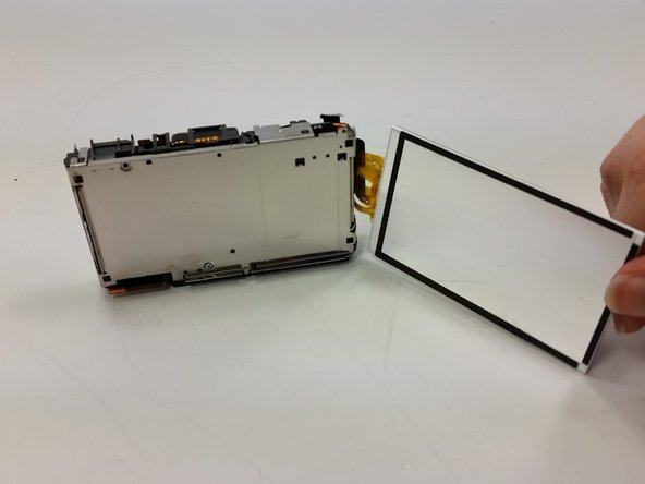

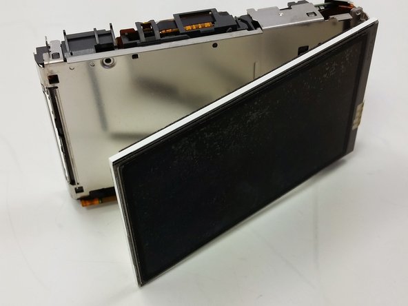

  12. Sony Cyber-shot DSC-TX7 LCD Screen Replacement, LCD Screen: crwdns2935265:012crwdnd2935265:01crwdnd2935265:03crwdne2935265:0 Sony Cyber-shot DSC-TX7 LCD Screen Replacement, LCD Screen: crwdns2935265:012crwdnd2935265:02crwdnd2935265:03crwdne2935265:0 Sony Cyber-shot DSC-TX7 LCD Screen Replacement, LCD Screen: crwdns2935265:012crwdnd2935265:03crwdnd2935265:03crwdne2935265:0
    • Pry the LCD screen using the spudger from the back of the camera.
    • Flip screen away from body of device.
  13. Sony Cyber-shot DSC-TX7 LCD Screen Replacement: crwdns2935265:013crwdnd2935265:01crwdnd2935265:01crwdne2935265:0
    • Lay the camera as shown, so that screen and camera body are next to each other, connected by the yellow ribbon.
    • Peel back the black sticker covering the motherboard.

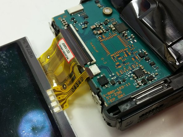

  14. Sony Cyber-shot DSC-TX7 LCD Screen Replacement: crwdns2935265:014crwdnd2935265:01crwdnd2935265:02crwdne2935265:0 Sony Cyber-shot DSC-TX7 LCD Screen Replacement: crwdns2935265:014crwdnd2935265:02crwdnd2935265:02crwdne2935265:0
    • Locate the yellow ribbon's connection port.
    • Flip the black bar holding the ribbon in place toward the body of the camera.
  15. Sony Cyber-shot DSC-TX7 LCD Screen Replacement: crwdns2935265:015crwdnd2935265:01crwdnd2935265:01crwdne2935265:0
    • Pull the yellow ribbon out of the connection port.
    • The LCD screen is now separate from the body of the device.
