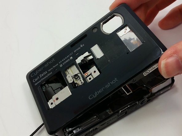

  5. Sony Cyber-shot DSC-TX7 Front Sliding Lens Cover Replacement: crwdns2935265:05crwdnd2935265:01crwdnd2935265:01crwdne2935265:0
    • Gently pry around the front cover using the plastic opening tool.
    • Carefully separate front cover from body of camera.
  6. Sony Cyber-shot DSC-TX7 Front Sliding Lens Cover Replacement: crwdns2935265:06crwdnd2935265:01crwdnd2935265:01crwdne2935265:0
    • The front cover is now removed from the camera and the internal hardware is now visible.
    • They front cover will still be connected by a ribbon. Be careful not to break the ribbon.
  7. Sony Cyber-shot DSC-TX7 Front Sliding Lens Cover Replacement, Front Sliding Lens Cover: crwdns2935265:07crwdnd2935265:01crwdnd2935265:02crwdne2935265:0 Sony Cyber-shot DSC-TX7 Front Sliding Lens Cover Replacement, Front Sliding Lens Cover: crwdns2935265:07crwdnd2935265:02crwdnd2935265:02crwdne2935265:0
    • Remove the three 4mm length screws located on the inside of the front cover with the Phillips #00 screwdriver.
  8. Sony Cyber-shot DSC-TX7 Front Sliding Lens Cover Replacement: crwdns2935265:08crwdnd2935265:01crwdnd2935265:02crwdne2935265:0 Sony Cyber-shot DSC-TX7 Front Sliding Lens Cover Replacement: crwdns2935265:08crwdnd2935265:02crwdnd2935265:02crwdne2935265:0
    • Wiggle sliding lens cover after all screws are removed and separate from front cover.
