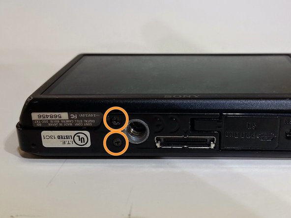

  3. Sony Cyber-shot DSC-TX7 Back Cover Replacement, Front Cover: crwdns2935265:03crwdnd2935265:01crwdnd2935265:01crwdne2935265:0
    • Use the Phillips #00 screwdriver to remove the 4mm length screws. There are 6 screws total.
  4. Sony Cyber-shot DSC-TX7 Back Cover Replacement: crwdns2935265:04crwdnd2935265:01crwdnd2935265:03crwdne2935265:0 Sony Cyber-shot DSC-TX7 Back Cover Replacement: crwdns2935265:04crwdnd2935265:02crwdnd2935265:03crwdne2935265:0 Sony Cyber-shot DSC-TX7 Back Cover Replacement: crwdns2935265:04crwdnd2935265:03crwdnd2935265:03crwdne2935265:0
    • The 4 mm length screws are located on each side and on the bottom of the camera.
    • 2 screws on each side (4 total).
    • 2 screws on bottom.

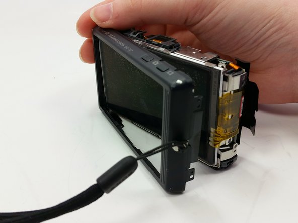

  6. Sony Cyber-shot DSC-TX7 Back Cover Replacement: crwdns2935265:06crwdnd2935265:01crwdnd2935265:01crwdne2935265:0
    • The front cover is now removed from the camera and the internal hardware is now visible.
    • They front cover will still be connected by a ribbon. Be careful not to break the ribbon.

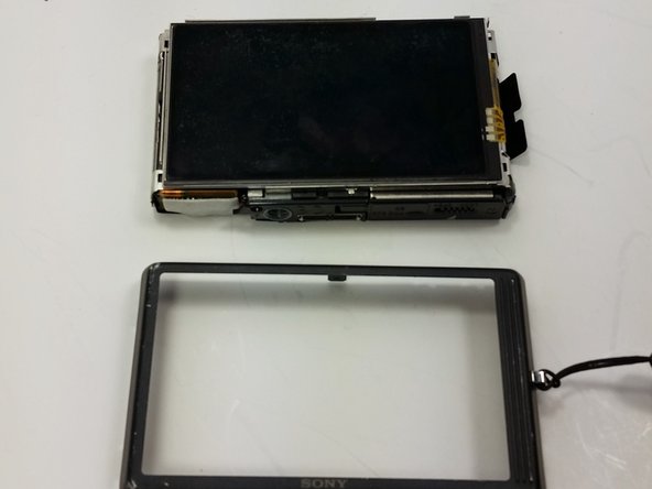

  7. Sony Cyber-shot DSC-TX7 Back Cover Replacement, Back Cover: crwdns2935265:07crwdnd2935265:01crwdnd2935265:01crwdne2935265:0
    • This is the camera with the front cover unscrewed and partially removed.

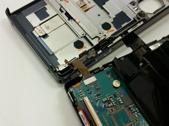

  8. Sony Cyber-shot DSC-TX7 Back Cover Replacement: crwdns2935265:08crwdnd2935265:01crwdnd2935265:02crwdne2935265:0 Sony Cyber-shot DSC-TX7 Back Cover Replacement: crwdns2935265:08crwdnd2935265:02crwdnd2935265:02crwdne2935265:0
    • Peel the black sticker from the motherboard.
    • Locate the connection ribbon between the front cover and the body of the device.
  9. Sony Cyber-shot DSC-TX7 Back Cover Replacement: crwdns2935265:09crwdnd2935265:01crwdnd2935265:02crwdne2935265:0 Sony Cyber-shot DSC-TX7 Back Cover Replacement: crwdns2935265:09crwdnd2935265:02crwdnd2935265:02crwdne2935265:0
    • Pull the ribbon out of the connection port so that they are completely disconnected.
