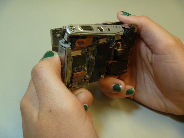

  7. Sony Cyber-shot DSC-T9 Motherboard Replacement, Back Cover: crwdns2935265:07crwdnd2935265:01crwdnd2935265:01crwdne2935265:0
    • This is the camera without the front cover.
  8. Sony Cyber-shot DSC-T9 Motherboard Replacement: crwdns2935265:08crwdnd2935265:01crwdnd2935265:01crwdne2935265:0

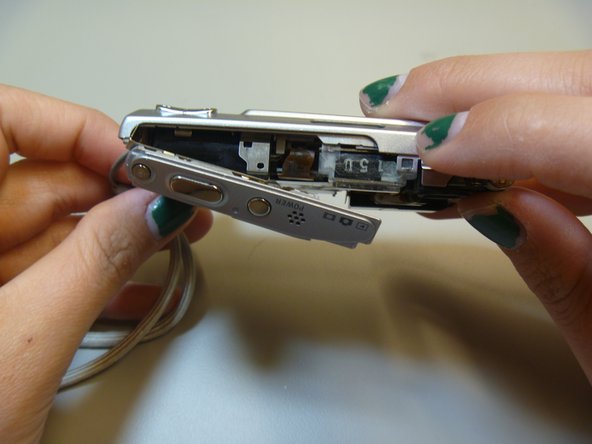

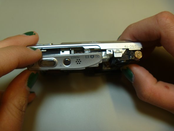

  9. Sony Cyber-shot DSC-T9 Motherboard Replacement: crwdns2935265:09crwdnd2935265:01crwdnd2935265:03crwdne2935265:0 Sony Cyber-shot DSC-T9 Motherboard Replacement: crwdns2935265:09crwdnd2935265:02crwdnd2935265:03crwdne2935265:0 Sony Cyber-shot DSC-T9 Motherboard Replacement: crwdns2935265:09crwdnd2935265:03crwdnd2935265:03crwdne2935265:0
    • Slide open the top panel. This is located on the top of the camera, where the power button and shutter button are.

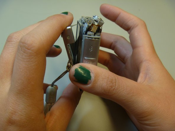

  10. Sony Cyber-shot DSC-T9 Motherboard Replacement: crwdns2935265:010crwdnd2935265:01crwdnd2935265:03crwdne2935265:0 Sony Cyber-shot DSC-T9 Motherboard Replacement: crwdns2935265:010crwdnd2935265:02crwdnd2935265:03crwdne2935265:0 Sony Cyber-shot DSC-T9 Motherboard Replacement: crwdns2935265:010crwdnd2935265:03crwdnd2935265:03crwdne2935265:0
    • Pull apart the inner hardware from the back case by prying on the left side.
  11. Sony Cyber-shot DSC-T9 Motherboard Replacement: crwdns2935265:011crwdnd2935265:01crwdnd2935265:01crwdne2935265:0
    • Remove the back cover.
  12. Sony Cyber-shot DSC-T9 Motherboard Replacement: crwdns2935265:012crwdnd2935265:01crwdnd2935265:01crwdne2935265:0
    • The back cover is now removed from the internal hardware.

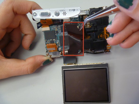

  15. Sony Cyber-shot DSC-T9 Motherboard Replacement: crwdns2935265:015crwdnd2935265:01crwdnd2935265:02crwdne2935265:0 Sony Cyber-shot DSC-T9 Motherboard Replacement: crwdns2935265:015crwdnd2935265:02crwdnd2935265:02crwdne2935265:0
    • Flip camera to other side.
    • Use tweezers to peel off black sticker, located in middle of the motherboard.
  16. Sony Cyber-shot DSC-T9 Motherboard Replacement: crwdns2935265:016crwdnd2935265:01crwdnd2935265:02crwdne2935265:0 Sony Cyber-shot DSC-T9 Motherboard Replacement: crwdns2935265:016crwdnd2935265:02crwdnd2935265:02crwdne2935265:0
    • Use pry stick to pop out LCD connector ribbon, also called the ZIF connector.
  17. Sony Cyber-shot DSC-T9 Motherboard Replacement: crwdns2935265:017crwdnd2935265:01crwdnd2935265:01crwdne2935265:0
    • The LCD is now removed from the camera.
