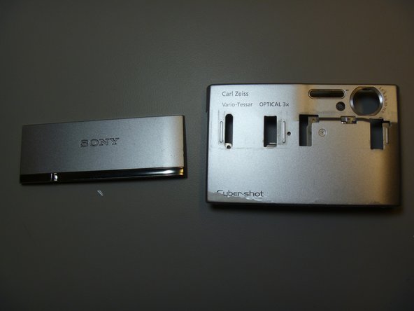

  5. Sony Cyber-shot DSC-T9 Front Sliding Lens Cover Replacement, Front Sliding Lens Cover: crwdns2935265:05crwdnd2935265:01crwdnd2935265:01crwdne2935265:0
    • The front sliding lens cover.

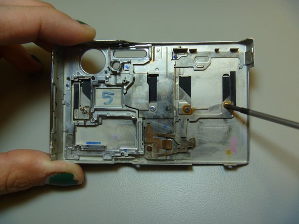

  6. Sony Cyber-shot DSC-T9 Front Sliding Lens Cover Replacement: crwdns2935265:06crwdnd2935265:01crwdnd2935265:02crwdne2935265:0 Sony Cyber-shot DSC-T9 Front Sliding Lens Cover Replacement: crwdns2935265:06crwdnd2935265:02crwdnd2935265:02crwdne2935265:0
    • Remove four screws using Phillips located on the inside of the front cover.

    • Remove front sliding lens cover.
  8. Sony Cyber-shot DSC-T9 Front Sliding Lens Cover Replacement: crwdns2935265:08crwdnd2935265:01crwdnd2935265:02crwdne2935265:0 Sony Cyber-shot DSC-T9 Front Sliding Lens Cover Replacement: crwdns2935265:08crwdnd2935265:02crwdnd2935265:02crwdne2935265:0
    • The front sliding lens cover is now removed and may be repair or replaced.
