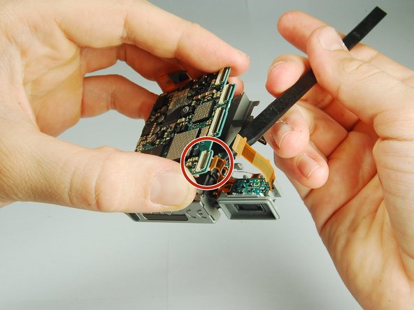

    • Use the tip of a spudger to flip up the tab on the ZIF connector securing the motherboard ribbon cable.
    • The second picture shows what these tabs look like in their open positions.

    • Turn the motherboard assembly over.
    • Use a spudger to open the ZIF connector on the motherboard.
    • Remove the ribbon cables from the opened clip.
