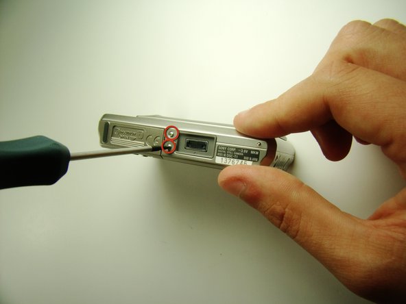

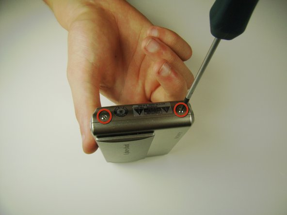

  3. Sony Cyber-shot DSC-T1 CCD chip Replacement, CCD chip: crwdns2935265:03crwdnd2935265:01crwdnd2935265:03crwdne2935265:0 Sony Cyber-shot DSC-T1 CCD chip Replacement, CCD chip: crwdns2935265:03crwdnd2935265:02crwdnd2935265:03crwdne2935265:0 Sony Cyber-shot DSC-T1 CCD chip Replacement, CCD chip: crwdns2935265:03crwdnd2935265:03crwdnd2935265:03crwdne2935265:0
    • Locate and remove the 3mm screws on the bottom and sides of the camera with a JIS size #0 screwdriver.
