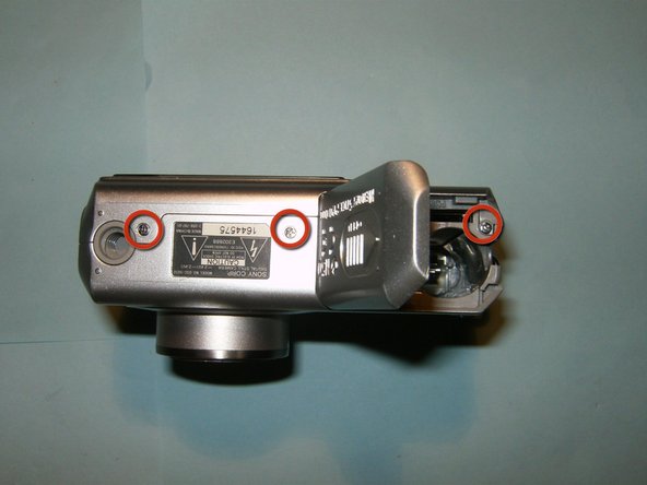

    • This is a camera that will not turn on. It has a partially stuck lens. (The stuck lens prevents the camera from turning on.)
    • Open the compartment on the bottom of the camera. Remove the batteries and memory card.
    • Turn the camera on its side, and remove the screw found under the USB-port cover.
  2. Sony Cyber-shot DSC-S650 Lens Replacement: crwdns2935265:02crwdnd2935265:01crwdnd2935265:03crwdne2935265:0 Sony Cyber-shot DSC-S650 Lens Replacement: crwdns2935265:02crwdnd2935265:02crwdnd2935265:03crwdne2935265:0 Sony Cyber-shot DSC-S650 Lens Replacement: crwdns2935265:02crwdnd2935265:03crwdnd2935265:03crwdne2935265:0
    • Remove the right middle cover.
    • Remove the screw from the left middle cover.
    • Remove the screw from the right side.
  3. Sony Cyber-shot DSC-S650 Lens Replacement: crwdns2935265:03crwdnd2935265:01crwdnd2935265:03crwdne2935265:0 Sony Cyber-shot DSC-S650 Lens Replacement: crwdns2935265:03crwdnd2935265:02crwdnd2935265:03crwdne2935265:0 Sony Cyber-shot DSC-S650 Lens Replacement: crwdns2935265:03crwdnd2935265:03crwdnd2935265:03crwdne2935265:0
    • Remove the two screws from the left side.
    • Remove the three screws from the bottom.
    • The bottom screws are not the same length. The shorter screw goes underneath the battery cover.
