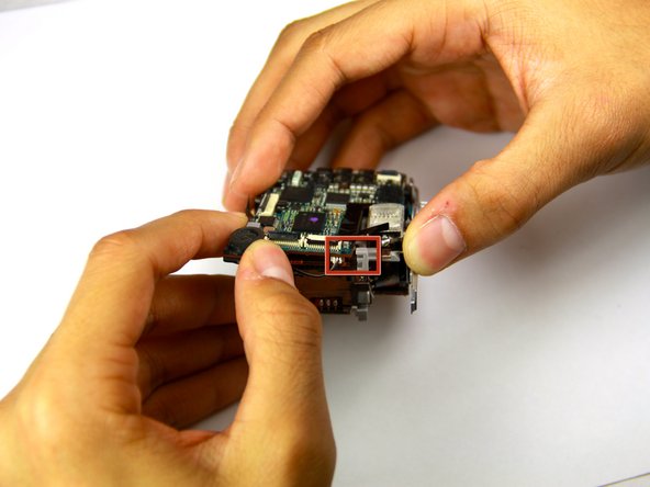

  16. Sony Cyber-shot DSC-P9 Motherboard Replacement, Motherboard: crwdns2935265:016crwdnd2935265:01crwdnd2935265:02crwdne2935265:0 Sony Cyber-shot DSC-P9 Motherboard Replacement, Motherboard: crwdns2935265:016crwdnd2935265:02crwdnd2935265:02crwdne2935265:0
    • Rotate the bottom panel upwards and pull away with your hand.
  17. Sony Cyber-shot DSC-P9 Motherboard Replacement: crwdns2935265:017crwdnd2935265:01crwdnd2935265:01crwdne2935265:0
    • Remove the one 2.5mm Phillips #000 screw on the bottom corner of the motherboard.

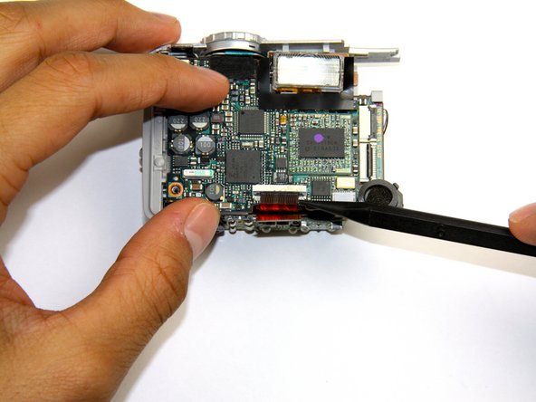

  18. Sony Cyber-shot DSC-P9 Motherboard Replacement: crwdns2935265:018crwdnd2935265:01crwdnd2935265:01crwdne2935265:0
    • Lift the black tab holding the top-left ribbon cable in place with the spudger tool.
    • Remove the ribbon cable with the spudger by carefully pulling the cable directly out of the slot.
    • Take care not to rip the ribbon cable when pulling it out.

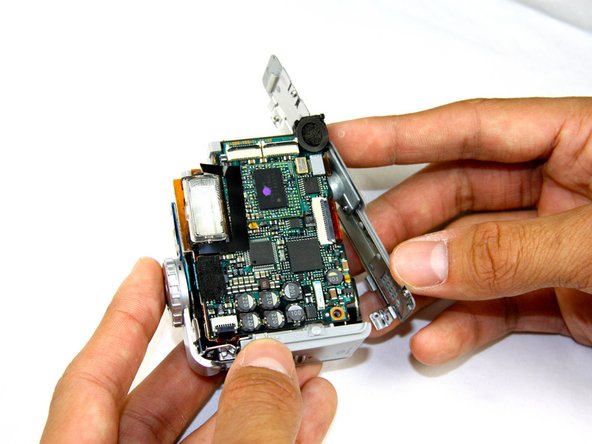

  21. Sony Cyber-shot DSC-P9 Motherboard Replacement: crwdns2935265:021crwdnd2935265:01crwdnd2935265:02crwdne2935265:0 Sony Cyber-shot DSC-P9 Motherboard Replacement: crwdns2935265:021crwdnd2935265:02crwdnd2935265:02crwdne2935265:0
    • Remove the ribbon cable to the right of the bottom two ribbon cables with the spudger.
  22. Sony Cyber-shot DSC-P9 Motherboard Replacement: crwdns2935265:022crwdnd2935265:01crwdnd2935265:02crwdne2935265:0 Sony Cyber-shot DSC-P9 Motherboard Replacement: crwdns2935265:022crwdnd2935265:02crwdnd2935265:02crwdne2935265:0
    • Pull the motherboard out of the slot on the side of the camera where the lens used to be attached.

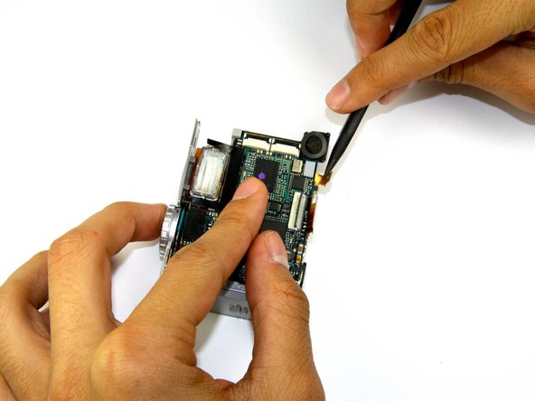

  23. Sony Cyber-shot DSC-P9 Motherboard Replacement: crwdns2935265:023crwdnd2935265:01crwdnd2935265:03crwdne2935265:0 Sony Cyber-shot DSC-P9 Motherboard Replacement: crwdns2935265:023crwdnd2935265:02crwdnd2935265:03crwdne2935265:0 Sony Cyber-shot DSC-P9 Motherboard Replacement: crwdns2935265:023crwdnd2935265:03crwdnd2935265:03crwdne2935265:0
    • Lift the motherboard away from the camera.
    • Detach the final ribbon cable connecting the motherboard to the rest of the camera.
  24. Sony Cyber-shot DSC-P9 Motherboard Replacement: crwdns2935265:024crwdnd2935265:01crwdnd2935265:01crwdne2935265:0
    • The motherboard should now be fully disconnected from the rest of the camera.
