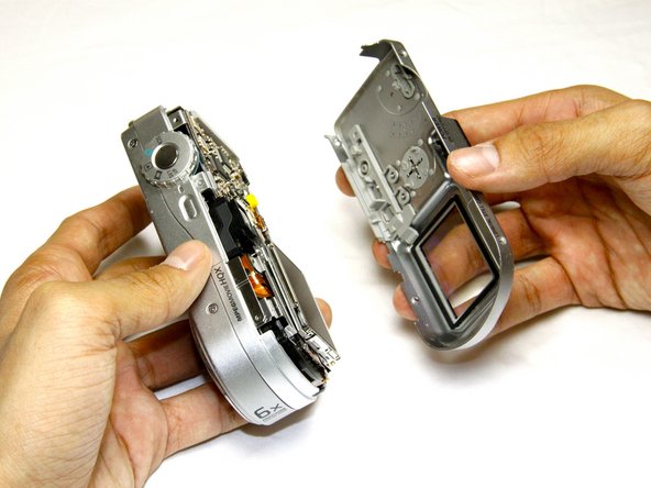

    • Unscrew the four 3.0mm Phillips #000 screws holding the back case onto the camera; there are two screws on top and two on the bottom.
  5. Sony Cyber-shot DSC-P9 LCD Replacement: crwdns2935265:05crwdnd2935265:01crwdnd2935265:02crwdne2935265:0 Sony Cyber-shot DSC-P9 LCD Replacement: crwdns2935265:05crwdnd2935265:02crwdnd2935265:02crwdne2935265:0
    • Pull the back case gently away from the rest of the camera.

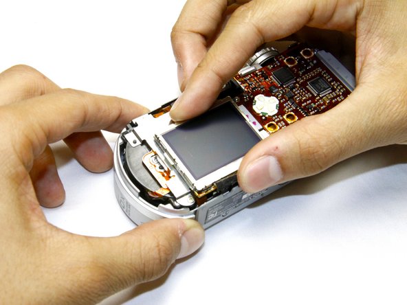

    • Remove the two 3.0mm Phillips #000 screws holding the display to the metal backing.
  7. Sony Cyber-shot DSC-P9 LCD Replacement: crwdns2935265:07crwdnd2935265:01crwdnd2935265:02crwdne2935265:0 Sony Cyber-shot DSC-P9 LCD Replacement: crwdns2935265:07crwdnd2935265:02crwdnd2935265:02crwdne2935265:0
    • Unlatch the display by sliding it towards the circuit board.
  8. Sony Cyber-shot DSC-P9 LCD Replacement: crwdns2935265:08crwdnd2935265:01crwdnd2935265:01crwdne2935265:0
    • Remove the two ribbon cables attached to the circuit board by gently pulling them out of their slots.
    • Be careful not to rip the ribbon cables while disconnecting them.
  9. Sony Cyber-shot DSC-P9 LCD Replacement: crwdns2935265:09crwdnd2935265:01crwdnd2935265:01crwdne2935265:0
    • The LCD is now separated from the camera.
