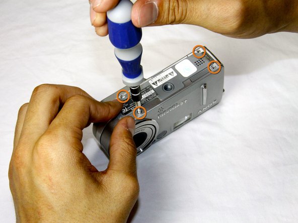

  4. Sony Cyber-shot DSC-P9 Flash Replacement, Outer Casing: crwdns2935265:04crwdnd2935265:01crwdnd2935265:02crwdne2935265:0 Sony Cyber-shot DSC-P9 Flash Replacement, Outer Casing: crwdns2935265:04crwdnd2935265:02crwdnd2935265:02crwdne2935265:0
    • Remove the four 3.0mm Phillips #000 screws on the top of the camera with the phillips screwdriver.
    • Remove the additional four 3.0mm Phillips #000 screws on the bottom of the camera.

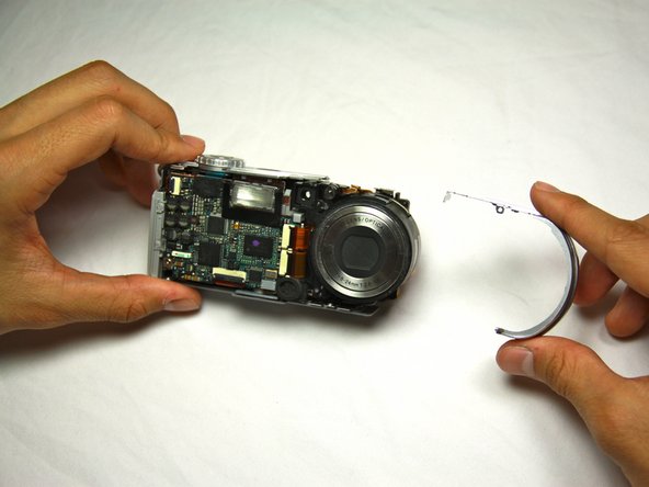

  8. Sony Cyber-shot DSC-P9 Flash Replacement, Lens: crwdns2935265:08crwdnd2935265:01crwdnd2935265:02crwdne2935265:0 Sony Cyber-shot DSC-P9 Flash Replacement, Lens: crwdns2935265:08crwdnd2935265:02crwdnd2935265:02crwdne2935265:0
    • Dislodge the round casing from the lens.
    • Pull it away from the rest of the camera.

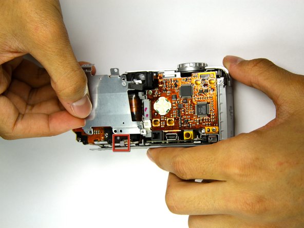

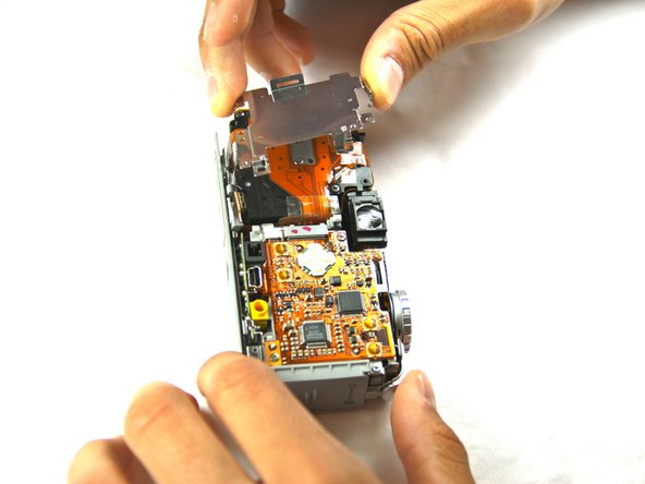

    • Work the back panel out from under the small grey clip.
    • Slide the back panel off of the camera by dislodging it from the remaining clips.
    • Below is a flat, orange cable connecting the lens to the motherboard.
    • Be careful not to bend the back plate during this process.

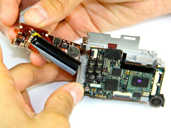

  16. Sony Cyber-shot DSC-P9 Flash Replacement, Flash: crwdns2935265:016crwdnd2935265:01crwdnd2935265:01crwdne2935265:0
    • Remove the 3.0mm Phillips #000 screw at the top of the battery door.
  17. Sony Cyber-shot DSC-P9 Flash Replacement: crwdns2935265:017crwdnd2935265:01crwdnd2935265:02crwdne2935265:0 Sony Cyber-shot DSC-P9 Flash Replacement: crwdns2935265:017crwdnd2935265:02crwdnd2935265:02crwdne2935265:0

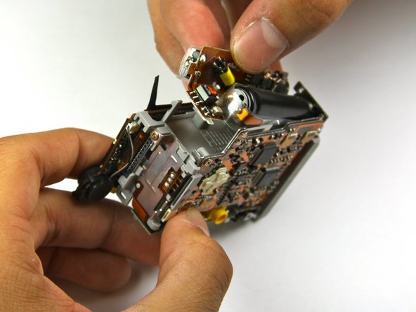

    • Pull off the top button piece. You will have to detach a small blue ribbon cable.

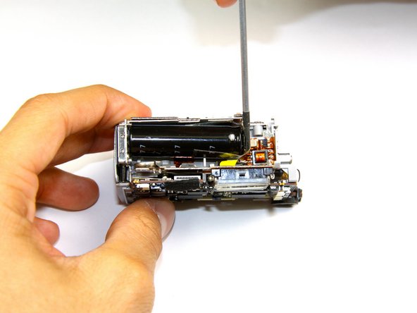

  18. Sony Cyber-shot DSC-P9 Flash Replacement: crwdns2935265:018crwdnd2935265:01crwdnd2935265:02crwdne2935265:0 Sony Cyber-shot DSC-P9 Flash Replacement: crwdns2935265:018crwdnd2935265:02crwdnd2935265:02crwdne2935265:0
    • Caution: the capacitor, a black cylinder near the top of the camera, might have a charge in it, which could be harmful to you or the camera. Neutralize it by touching both wires with a screwdriver at the same time.
  19. Sony Cyber-shot DSC-P9 Flash Replacement: crwdns2935265:019crwdnd2935265:01crwdnd2935265:03crwdne2935265:0 Sony Cyber-shot DSC-P9 Flash Replacement: crwdns2935265:019crwdnd2935265:02crwdnd2935265:03crwdne2935265:0 Sony Cyber-shot DSC-P9 Flash Replacement: crwdns2935265:019crwdnd2935265:03crwdnd2935265:03crwdne2935265:0
    • Remove the flash mechanism. It is held in place by a clip on the side of the camera.
    • The capacitor and flash will rotate out, still attached by a ribbon cable on the left.
  20. Sony Cyber-shot DSC-P9 Flash Replacement: crwdns2935265:020crwdnd2935265:01crwdnd2935265:02crwdne2935265:0 Sony Cyber-shot DSC-P9 Flash Replacement: crwdns2935265:020crwdnd2935265:02crwdnd2935265:02crwdne2935265:0
    • Lift up the black tab with the spudger.
    • Gently remove the ribbon cable from the rest of the camera.
    • The flash component is now completely separate from the rest of the camera.
