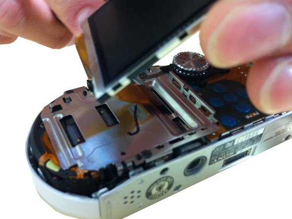

  3. Sony Cyber-shot DSC-P100 LCD Screen Replacement, LCD Screen: crwdns2935265:03crwdnd2935265:01crwdnd2935265:01crwdne2935265:0
    • Using a pry tool, gently pry the top right corner of the LCD screen. Pry the screen until the four tabs release it from its current position.

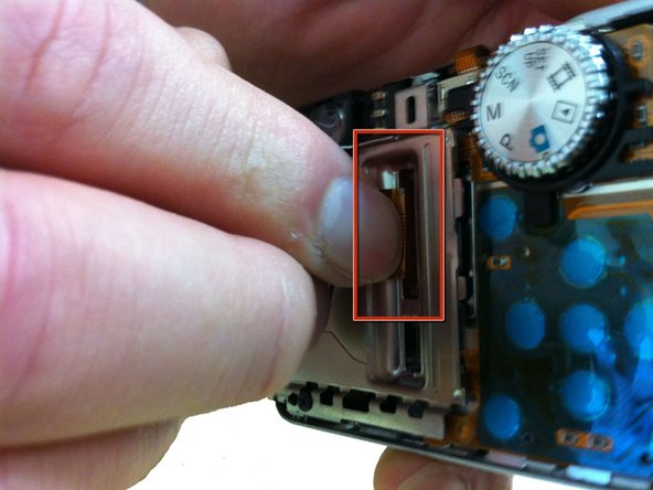

  4. Sony Cyber-shot DSC-P100 LCD Screen Replacement: crwdns2935265:04crwdnd2935265:01crwdnd2935265:02crwdne2935265:0 Sony Cyber-shot DSC-P100 LCD Screen Replacement: crwdns2935265:04crwdnd2935265:02crwdnd2935265:02crwdne2935265:0
    • Push the metal tab on the right side of the screen until the plate underneath the LCD screen is released.
  5. Sony Cyber-shot DSC-P100 LCD Screen Replacement: crwdns2935265:05crwdnd2935265:01crwdnd2935265:02crwdne2935265:0 Sony Cyber-shot DSC-P100 LCD Screen Replacement: crwdns2935265:05crwdnd2935265:02crwdnd2935265:02crwdne2935265:0
    • Unfold the LCD screen and the plate underneath.
    • Now visible are the ribbon cables holding the screen and plate in place.
  6. Sony Cyber-shot DSC-P100 LCD Screen Replacement: crwdns2935265:06crwdnd2935265:01crwdnd2935265:03crwdne2935265:0 Sony Cyber-shot DSC-P100 LCD Screen Replacement: crwdns2935265:06crwdnd2935265:02crwdnd2935265:03crwdne2935265:0 Sony Cyber-shot DSC-P100 LCD Screen Replacement: crwdns2935265:06crwdnd2935265:03crwdnd2935265:03crwdne2935265:0
    • Remove the LCD screen plate by gently pulling upward on the ribbon cable until the screen is removed from the camera.
