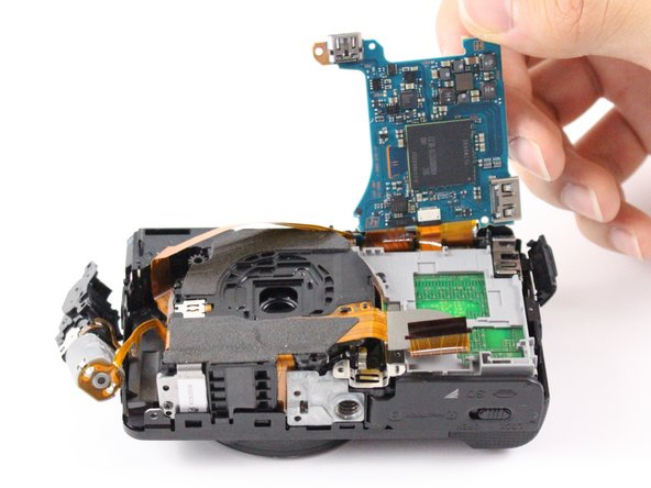

  14. Sony Cyber-shot DSC-HX9V Lens Replacement: crwdns2935265:014crwdnd2935265:01crwdnd2935265:02crwdne2935265:0 Sony Cyber-shot DSC-HX9V Lens Replacement: crwdns2935265:014crwdnd2935265:02crwdnd2935265:02crwdne2935265:0
    • The mainboard is held in place by the marked locking tang. Using your fingers, push the locking tang away from the mainboard. If you cannot push with your fingers, a plastic spudger can be used instead.
    • Do not lift the mainboard past the perpendicular position. Permanent damage to the connected data cable may occur if the mainboard is pushed or pulled too far.
    • While holding the locking tang back, lift the mainboard to the perpendicular position.
  15. Sony Cyber-shot DSC-HX9V Lens Replacement: crwdns2935265:015crwdnd2935265:01crwdnd2935265:01crwdne2935265:0
    • While holding the mainboard in the perpendicular position, use your other hand to carefully lift the camera lens straight up and out of the case.
    • The lens data cable runs under the mainboard. Upon installation of the lens, route the lens data cable under the mainboard before you latch the mainboard down to the case.

One step was skipped, prior to removing the mainboard you need to remove the CCD photodiode thing that plugs into the lens housing.
rezilient - crwdns2934203:0crwdne2934203:0
Yes. It’s the actual camera sensor. It doesn’t have to be unscrewed from back of lens - only disconnect cable very carefully.
