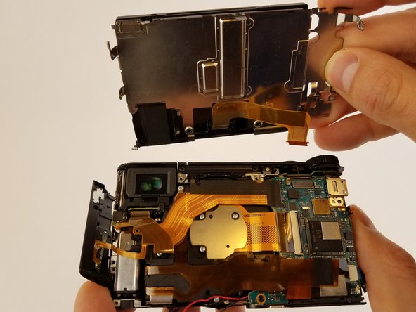

  9. Sony Cyber-shot DSC-HX90V Lens Replacement: crwdns2935265:09crwdnd2935265:01crwdnd2935265:01crwdne2935265:0
    • LCD screen is very fragile. Handle with care. Do not use tools to remove the screen.
    • Lift the metal plate and LCD screen simultaneously until it is perpendicular to the camera.
  10. Sony Cyber-shot DSC-HX90V Lens Replacement, Motherboard: crwdns2935265:010crwdnd2935265:01crwdnd2935265:02crwdne2935265:0 Sony Cyber-shot DSC-HX90V Lens Replacement, Motherboard: crwdns2935265:010crwdnd2935265:02crwdnd2935265:02crwdne2935265:0
    • Remove the ribbon cable connecting LCD display to camera sensor and battery housing.

Aside from a few missed screws, very nicely done. And I suspect that if one didn’t realize the need to remove those screws, sh/e probably shouldn’t be attempting the job in the first place. :) (I noted the comments after completing lens removal.)
Leon - crwdns2934203:0crwdne2934203:0
Can you comment where/specifically the missing screws that were not listed can be found? Any other guides out there that are more comprehensive?
Eric C -
First at step 7
Dufour -
At step 8 remove two 2mm screws both lower sides of LCD
