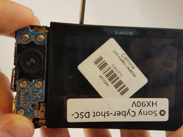

    • Remove the marked screw with a Phillips #000 screwdriver.
    • Remove the marked black M1.4 X 3.5 Phillips head screws
    • Use the spudger to gently remove the lower panel.
  2. Sony Cyber-shot DSC-HX90V Button Board  Replacement: crwdns2935265:02crwdnd2935265:01crwdnd2935265:03crwdne2935265:0 Sony Cyber-shot DSC-HX90V Button Board  Replacement: crwdns2935265:02crwdnd2935265:02crwdnd2935265:03crwdne2935265:0 Sony Cyber-shot DSC-HX90V Button Board  Replacement: crwdns2935265:02crwdnd2935265:03crwdnd2935265:03crwdne2935265:0
    • After removing the marked black M1.4 X 3.5 Phillips head screws with the Phillips #000 screwdriver on the side panel, using the spudger where the red arrow marks, insert and gently remove the side panel from the device.
    • From either corner of the button board gently use hands to remove the button board.

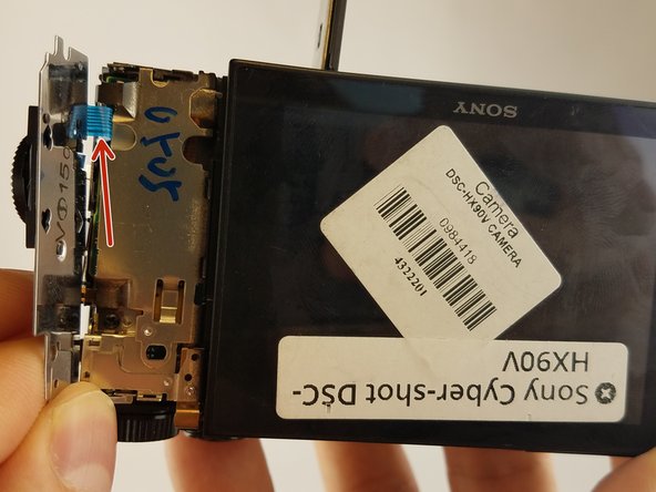

  3. Sony Cyber-shot DSC-HX90V Button Board  Replacement: crwdns2935265:03crwdnd2935265:01crwdnd2935265:03crwdne2935265:0 Sony Cyber-shot DSC-HX90V Button Board  Replacement: crwdns2935265:03crwdnd2935265:02crwdnd2935265:03crwdne2935265:0 Sony Cyber-shot DSC-HX90V Button Board  Replacement: crwdns2935265:03crwdnd2935265:03crwdnd2935265:03crwdne2935265:0
    • After the outer black panel case of button is removed, gently disconnect the control board data cable to the motherboard utilizing the tweezers gently where the red arrow marks.
    • Ribbon wires can easily be damaged.
