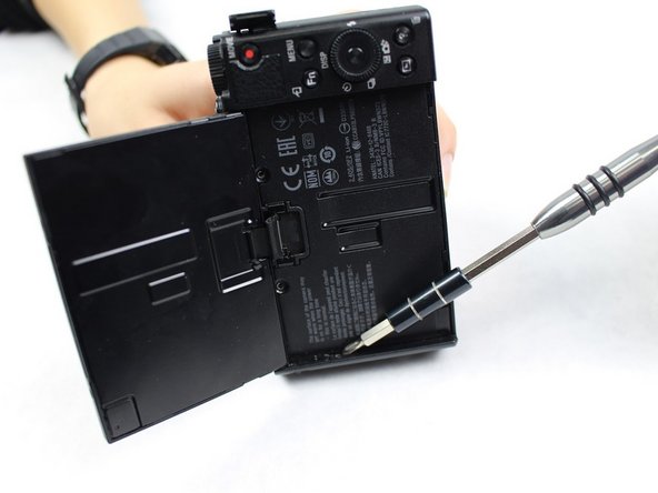

    • Flip the LCD screen upwards. Use the PH000 Phillips head screwdriver to remove screws located under the LCD screen.
    • For this step there will be an additional three 0.3 mm black Phillips screws. Place them on magnetic mat or plastic bag.

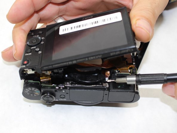

    • After loosening the plastic edges of the camera, gently pull the LCD screen upwards.

I’m stuck on step 7. The plastic covers on the left side (viewing the camera as you would hold it to take a picture) and on the bottom are separating from the rest of the camera; the left side cover is attached by a thin wire. But I cannot separate the back with the LCD panel from the front with the lens.

I appreciate that there is a HX80 Lens replacement posting on ifixit.com, but unfortunately, this one is not very useful, and may lull folks into thinking it's enough information to do the job, which it is definitely not. Biggest problem starts in step 8, which omits the fact that you need to detach the display supporting frame with 2 black screws on the edges and one that's hidden underneath the keypad board, after popping out this board. Then, you need to detach the display flex-cable connector, the viewfinder's flex-cable connector, and the lens unit's flex-cable connector. You do not want to remove the screws indicated in step 8, as they are part of the lens unit you're replacing. Removing and attaching the flex-cable connectors involves moving the plastic retainer clip at the back of the fixed connector, using a soft tool like a toothpick. Sorry, I don't have pictures to add. Look at the YouTube video for HX50 lens replacement to get an idea. Oh, and you'll need to carefully move the CCD sensor from the old lens unit to the new one - 3 screws, and yet another flex-cable to detach and re-attach. DON'T touch the CCD side of the unit or the lens on the replacement lens unit!
