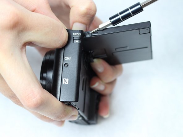

    • Flip LCD screen upwards.
    • Use the PH000 Phillips head screwdriver to remove the two 0.3 mm Phillips black screws located on the sides of the LCD screen. Place screws on magnetic mat or plastic bag.
