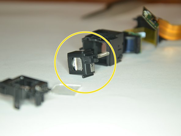

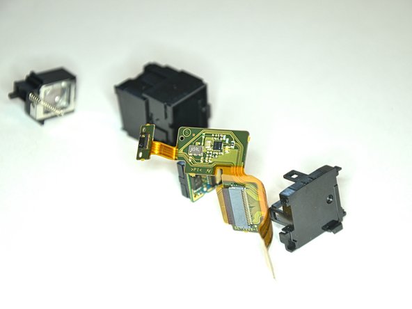

  10. Sony Cyber-shot DSC-HX400V Teardown, Viewfinder Insides: crwdns2935265:010crwdnd2935265:01crwdnd2935265:03crwdne2935265:0 Sony Cyber-shot DSC-HX400V Teardown, Viewfinder Insides: crwdns2935265:010crwdnd2935265:02crwdnd2935265:03crwdne2935265:0 Sony Cyber-shot DSC-HX400V Teardown, Viewfinder Insides: crwdns2935265:010crwdnd2935265:03crwdnd2935265:03crwdne2935265:0
    • Frontglass holder
    • Frontglass, you may want to clean it, if you have disassembled it
    • Lens with spring. This is used to give you a sharp view into the viewfinder. The small nib is pushed in different positions by the small dial on the case to adjust the focus for your eyes
    • Monitor, a very small monitor. Looks much like the image sensor.
    • Proximity sensor for detecting your eye and therefore switching to the viewfinder.
    • PCB with 2 unidentified ICs (659L and 3232 615)
    • Backcover

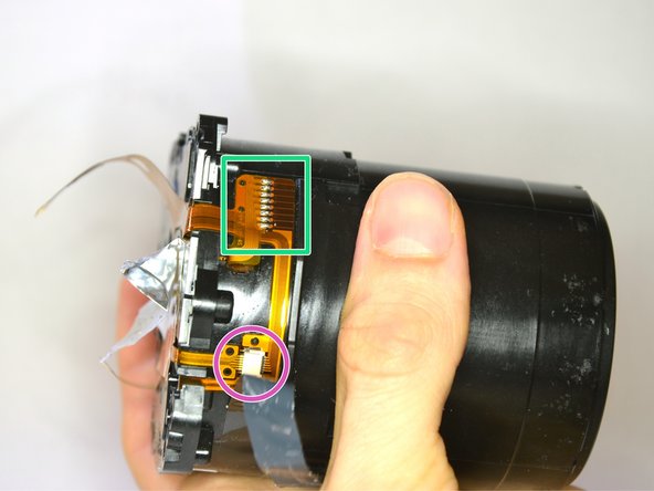

  15. Sony Cyber-shot DSC-HX400V Teardown, Sensorbackplate: crwdns2935265:015crwdnd2935265:01crwdnd2935265:03crwdne2935265:0 Sony Cyber-shot DSC-HX400V Teardown, Sensorbackplate: crwdns2935265:015crwdnd2935265:02crwdnd2935265:03crwdne2935265:0 Sony Cyber-shot DSC-HX400V Teardown, Sensorbackplate: crwdns2935265:015crwdnd2935265:03crwdnd2935265:03crwdne2935265:0
    • Unscrew these 6 screws, after you have taken the optics out of the case. Note that the three motor screws where in place during the photo, but should be removed first
    • To be able to separate the Sensorbackplate from the rest, you have to unsolder the conenctor
    • Also disconnect this connector, as well as the connector on the opposite site
    • Finally you have the sensor with (maybe?) the auto focus lens.
    • If you have dust on your images, it is not necessarily on the sensor. It is rather unlikely because it is enclosed from the auto focus lens. Maybe you should search on other part of the optics first

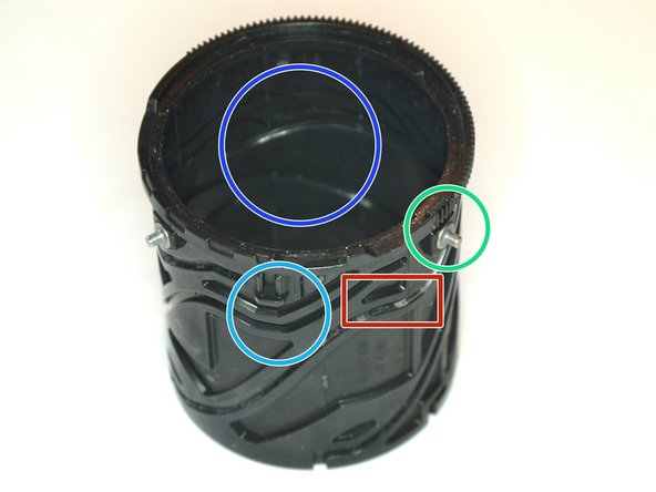

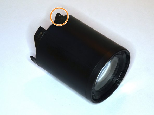

  17. Sony Cyber-shot DSC-HX400V Teardown, Tubes: crwdns2935265:017crwdnd2935265:01crwdnd2935265:03crwdne2935265:0 Sony Cyber-shot DSC-HX400V Teardown, Tubes: crwdns2935265:017crwdnd2935265:02crwdnd2935265:03crwdne2935265:0 Sony Cyber-shot DSC-HX400V Teardown, Tubes: crwdns2935265:017crwdnd2935265:03crwdnd2935265:03crwdne2935265:0
    • The outer case has a gear mount and grooves for the inner tube.
    • This tube has the front lens integrated and is visible to the outside when the camera is turned on and zooming.
    • The inner tube moves all 4 lenses.
    • This groove moves the tube with the front lens.
    • The three inner grooves moves the image stabilisation, the shutter and an additional lens.
    • This nip interacts with the grooves in the outer tube.
    • This is the dust and dirt that was stopping the objective from moving out. It isn't much. So, be careful and keep yours clean. I was not able to completely remove it in my camera, but it is working now with some help.

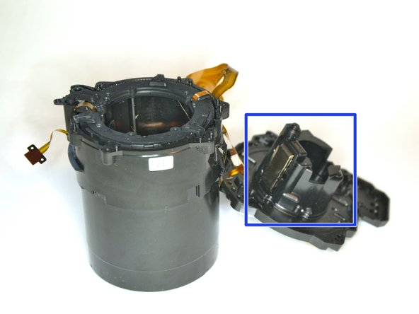

  18. Sony Cyber-shot DSC-HX400V Teardown, Lens Groups: crwdns2935265:018crwdnd2935265:01crwdnd2935265:03crwdne2935265:0 Sony Cyber-shot DSC-HX400V Teardown, Lens Groups: crwdns2935265:018crwdnd2935265:02crwdnd2935265:03crwdne2935265:0 Sony Cyber-shot DSC-HX400V Teardown, Lens Groups: crwdns2935265:018crwdnd2935265:03crwdnd2935265:03crwdne2935265:0
    • Unscrew all 5 screws to remove the rod holder. Then you can separate all three optics groups.
    • This is a moving lens with no other purpose
    • This is the shutter and aperture module. It also integrates some lenses.
    • This is the image stabilisator, which contains two coils and magnets.
