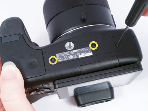

    • Make sure the camera is powered off
    • Turn the camera upside down. This is a view of the bottom of the camera.

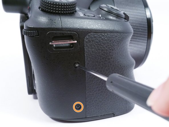

    • Remove the 3 (4 cm) Philips head screws holding the plastic camera housing together. They are located on the back of the camera.
    • Remove the 2 (4 cm) Phillips head screws on the right side of the camera.
    • Turn the camera upside down and remove the remaining 3 (4 cm) Phillips head screws holding the plastic housing together.

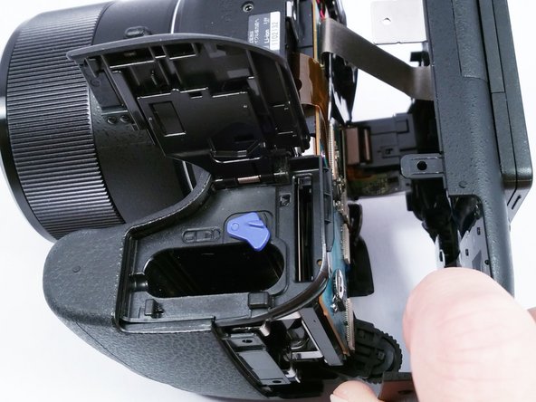

  6. Sony Cyber-shot DSC-HX300 View Finder Replacement: crwdns2935265:06crwdnd2935265:01crwdnd2935265:02crwdne2935265:0 Sony Cyber-shot DSC-HX300 View Finder Replacement: crwdns2935265:06crwdnd2935265:02crwdnd2935265:02crwdne2935265:0
    • Using a plastic opening tool, separate the plastic camera housing.
  7. Sony Cyber-shot DSC-HX300 View Finder Replacement: crwdns2935265:07crwdnd2935265:01crwdnd2935265:01crwdne2935265:0
    • Disconnect the ribbon wire attaching the screen to the camera.

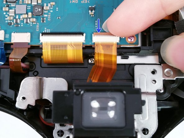

  8. Sony Cyber-shot DSC-HX300 View Finder Replacement: crwdns2935265:08crwdnd2935265:01crwdnd2935265:02crwdne2935265:0 Sony Cyber-shot DSC-HX300 View Finder Replacement: crwdns2935265:08crwdnd2935265:02crwdnd2935265:02crwdne2935265:0
    • Remove the 1 (2 cm) Phillips head screw
    • Remove the 2 (5 cm) Phillips head screws that mount the View Finder to the camera.
    • Carefully disconnect the ribbon wire that connects the View Finder to the Motherboard.

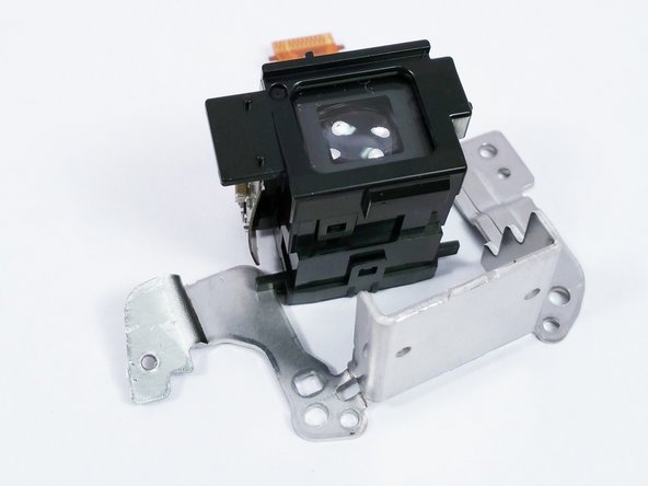

  9. Sony Cyber-shot DSC-HX300 View Finder Replacement: crwdns2935265:09crwdnd2935265:01crwdnd2935265:02crwdne2935265:0 Sony Cyber-shot DSC-HX300 View Finder Replacement: crwdns2935265:09crwdnd2935265:02crwdnd2935265:02crwdne2935265:0
    • Gently pull the plastic View Finder off of the metal mounting bracket.
  10. Sony Cyber-shot DSC-HX300 View Finder Replacement: crwdns2935265:010crwdnd2935265:01crwdnd2935265:01crwdne2935265:0
    • The replacement View Finder can now be installed.
