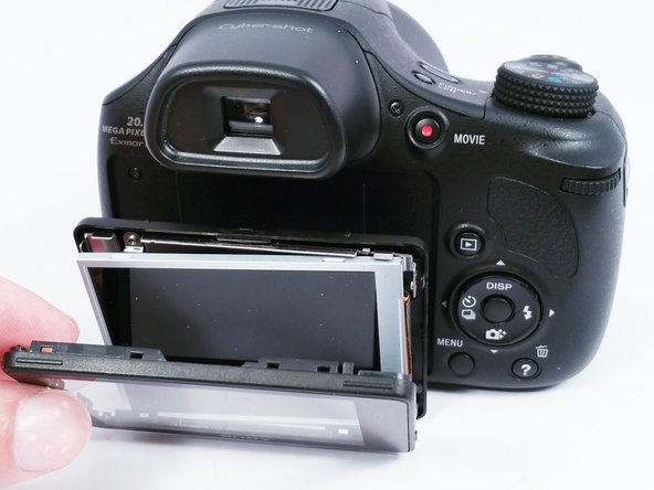

    • Remove the plastic cover from the back of the LCD display by simply sliding it up and off of the camera.
  9. Sony Cyber-shot DSC-HX300 LCD Screen Replacement: crwdns2935265:09crwdnd2935265:01crwdnd2935265:02crwdne2935265:0 Sony Cyber-shot DSC-HX300 LCD Screen Replacement: crwdns2935265:09crwdnd2935265:02crwdnd2935265:02crwdne2935265:0

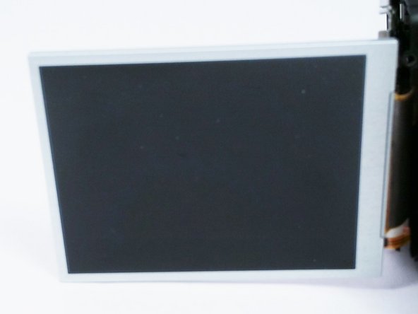

    • Using a plastic opening tool, carefully remove the plastic housing that surrounds the LCD display.
  10. Sony Cyber-shot DSC-HX300 LCD Screen Replacement: crwdns2935265:010crwdnd2935265:01crwdnd2935265:03crwdne2935265:0 Sony Cyber-shot DSC-HX300 LCD Screen Replacement: crwdns2935265:010crwdnd2935265:02crwdnd2935265:03crwdne2935265:0 Sony Cyber-shot DSC-HX300 LCD Screen Replacement: crwdns2935265:010crwdnd2935265:03crwdnd2935265:03crwdne2935265:0
    • Once the plastic housing is separated, disconnect the ribbon wire located on the back of the LCD display. This can be achieved by pulling up lightly on the brown bar that locks the ribbon wire to the circuit board..
    • Disconnect the remaining two ribbon wires the same way. They are located on the right, rear side of the LCD frame.
  11. Sony Cyber-shot DSC-HX300 LCD Screen Replacement: crwdns2935265:011crwdnd2935265:01crwdnd2935265:01crwdne2935265:0
    • Using a small Phillips head screwdriver, remove the last 2 cm screw that mounts the circuit board to the metal LCD display frame.
  12. Sony Cyber-shot DSC-HX300 LCD Screen Replacement: crwdns2935265:012crwdnd2935265:01crwdnd2935265:02crwdne2935265:0 Sony Cyber-shot DSC-HX300 LCD Screen Replacement: crwdns2935265:012crwdnd2935265:02crwdnd2935265:02crwdne2935265:0
    • Once the circuit board is removed the replacement parts can be installed in the reverse order.
