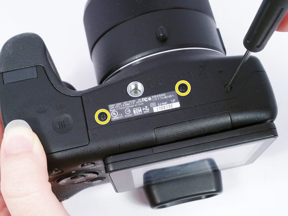

    • Make sure to remove the battery before disassembly to prevent electrocution.
    • Remove the 3 (4 cm) Phillips head screws located on the back of the camera.

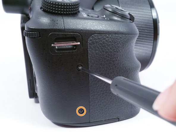

    • Remove the 2 (4 cm) Phillips head screws on the right side of the camera.
    • Turn the camera upside down to remove the remaining the 3 (4 cm) Phillips head screws holding the plastic camera housing together.
