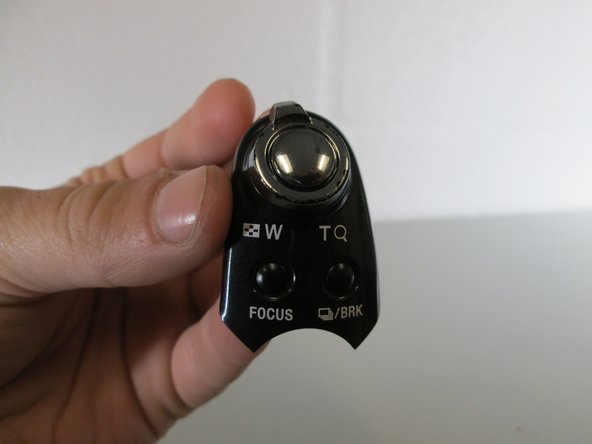

  4. Sony Cyber-shot DSC-HX1 Button Assembly Replacement, Button Assembly: crwdns2935265:04crwdnd2935265:01crwdnd2935265:01crwdne2935265:0
    • On the top of the inside the battery compartment, remove the #00 6.0 mm Phillips screw.
  5. Sony Cyber-shot DSC-HX1 Button Assembly Replacement: crwdns2935265:05crwdnd2935265:01crwdnd2935265:02crwdne2935265:0 Sony Cyber-shot DSC-HX1 Button Assembly Replacement: crwdns2935265:05crwdnd2935265:02crwdnd2935265:02crwdne2935265:0
    • Lift the button housing from its position on top of the camera.
