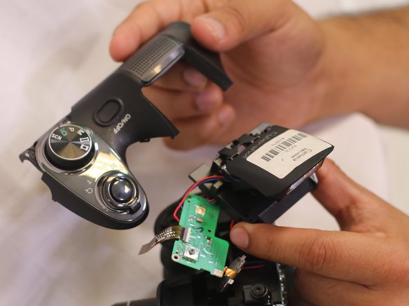

  4. Sony Cyber-shot DSC-H300 Flash Replacement, Flash: crwdns2935265:04crwdnd2935265:01crwdnd2935265:03crwdne2935265:0 Sony Cyber-shot DSC-H300 Flash Replacement, Flash: crwdns2935265:04crwdnd2935265:02crwdnd2935265:03crwdne2935265:0 Sony Cyber-shot DSC-H300 Flash Replacement, Flash: crwdns2935265:04crwdnd2935265:03crwdnd2935265:03crwdne2935265:0
    • Remove the six 6mm Phillips #00 screws from the upper case of the camera.
    • Remove the upper case.
  5. Sony Cyber-shot DSC-H300 Flash Replacement: crwdns2935265:05crwdnd2935265:01crwdnd2935265:02crwdne2935265:0 Sony Cyber-shot DSC-H300 Flash Replacement: crwdns2935265:05crwdnd2935265:02crwdnd2935265:02crwdne2935265:0
    • Remove the four 6mm Phillips #000 screws from the bottom of the case.
  6. Sony Cyber-shot DSC-H300 Flash Replacement: crwdns2935265:06crwdnd2935265:01crwdnd2935265:02crwdne2935265:0 Sony Cyber-shot DSC-H300 Flash Replacement: crwdns2935265:06crwdnd2935265:02crwdnd2935265:02crwdne2935265:0
    • Slide the flash out and away from the camera to remove.
