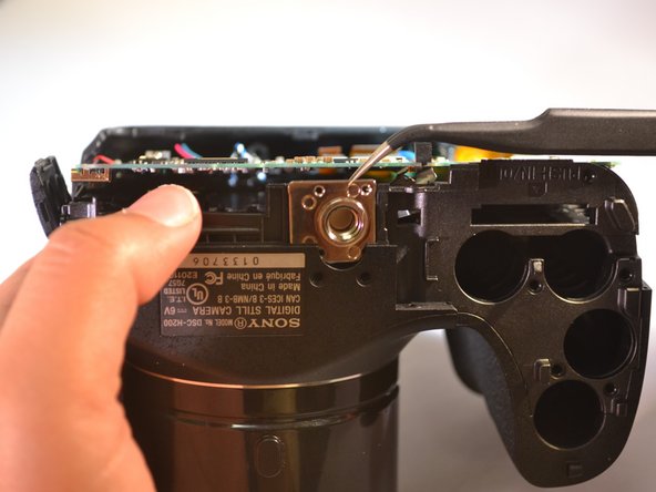

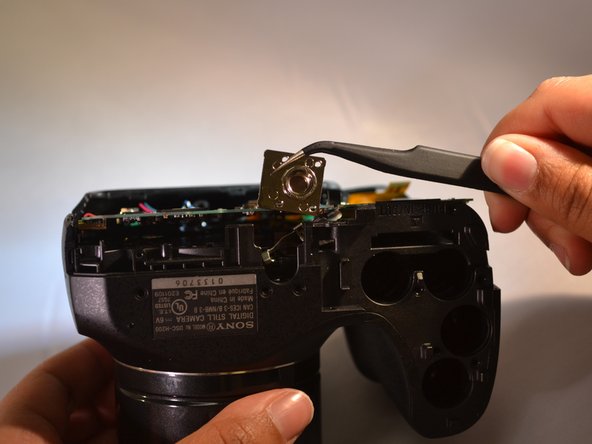

  14. Sony Cyber-shot DSC-H200 Tripod Port Replacement: crwdns2935265:014crwdnd2935265:01crwdnd2935265:01crwdne2935265:0
    • Lift the motherboard away from the camera body (the tripod port is exposed)
  15. Sony Cyber-shot DSC-H200 Tripod Port Replacement: crwdns2935265:015crwdnd2935265:01crwdnd2935265:03crwdne2935265:0 Sony Cyber-shot DSC-H200 Tripod Port Replacement: crwdns2935265:015crwdnd2935265:02crwdnd2935265:03crwdne2935265:0 Sony Cyber-shot DSC-H200 Tripod Port Replacement: crwdns2935265:015crwdnd2935265:03crwdnd2935265:03crwdne2935265:0
    • Using tweezers, lift the tripod port up and away from the camera body
