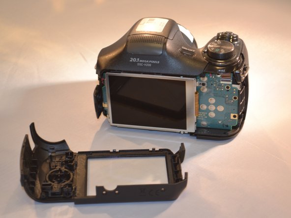

    • Using the blue plastic opening tools, remove the back panel (the LCD and motherboard are exposed).

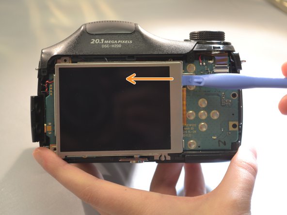

    • Using a screwdriver, remove the three 4mm screws that attach the LCD to the camera motherboard (The LCD is contained in a holding plate, attached to the motherboard with a ribbon cable).
    • Using the blue plastic opening tool remove the LCD Screen from the motherboard.

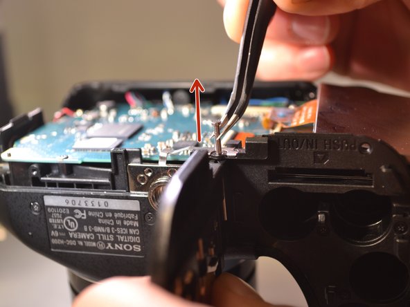

    • Lift the holding plate away from the motherboard and set aside (the pin attaching the door to the body is now accessible).
  8. Sony Cyber-shot DSC-H200 SD Door Replacement: crwdns2935265:08crwdnd2935265:01crwdnd2935265:02crwdne2935265:0 Sony Cyber-shot DSC-H200 SD Door Replacement: crwdns2935265:08crwdnd2935265:02crwdnd2935265:02crwdne2935265:0
    • Using tweezers remove the pin that attaches the door to the body.
  9. Sony Cyber-shot DSC-H200 SD Door Replacement: crwdns2935265:09crwdnd2935265:01crwdnd2935265:01crwdne2935265:0
    • Remove the door.
