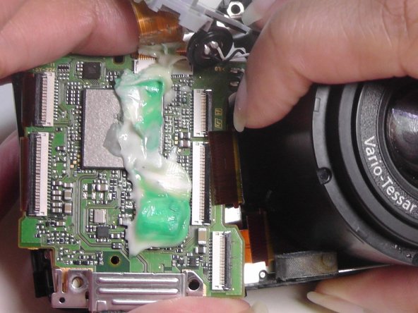

    • Lift up the gray plastic facing in order to uncover the motherboard and the ribbon cable ports.
  10. Sony Cyber-shot DSC-H20 Lens Assembly Replacement: crwdns2935265:010crwdnd2935265:01crwdnd2935265:02crwdne2935265:0 Sony Cyber-shot DSC-H20 Lens Assembly Replacement: crwdns2935265:010crwdnd2935265:02crwdnd2935265:02crwdne2935265:0
    • Carefully flip up the three black clasps holding the lens cables to the motherboard.
    • Slide the cables from the ports.
  11. Sony Cyber-shot DSC-H20 Lens Assembly Replacement: crwdns2935265:011crwdnd2935265:01crwdnd2935265:01crwdne2935265:0
    • Lift the lens and attached ribbon cables from the camera in order to switch this lens with a new one.
