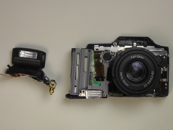

    • Pry the front cover of the camera off with the plastic opening tool.
  7. Sony Cyber-shot DSC-H20 Flash Assembly Replacement: crwdns2935265:07crwdnd2935265:01crwdnd2935265:01crwdne2935265:0
    • Remove the power shutter unit
  8. Sony Cyber-shot DSC-H20 Flash Assembly Replacement: crwdns2935265:08crwdnd2935265:01crwdnd2935265:02crwdne2935265:0 Sony Cyber-shot DSC-H20 Flash Assembly Replacement: crwdns2935265:08crwdnd2935265:02crwdnd2935265:02crwdne2935265:0
    • Unscrew the screw located at the back left corner of the flash component.
    • Set the flash component aside.
