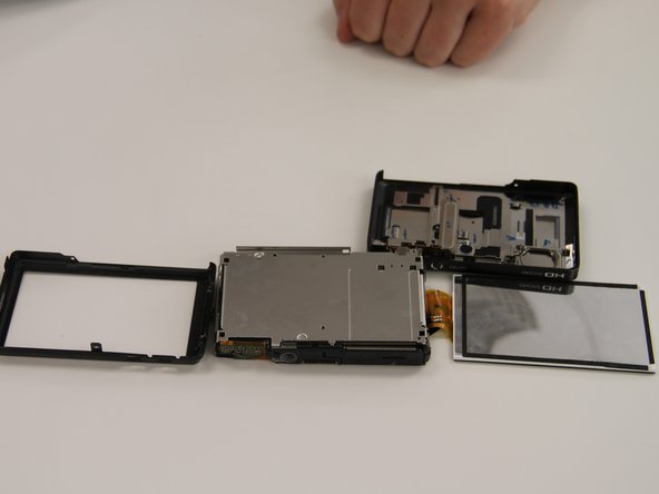

    • Remove all screws on the outside of the camera. A total of 6 screws will be removed.
    • Use a 0001 screw. Note: That the first two screws are in the first circle.
  2. Sony Cyber-Shot DSC-TX9 LED Screen Replacement: crwdns2935265:02crwdnd2935265:01crwdnd2935265:03crwdne2935265:0 Sony Cyber-Shot DSC-TX9 LED Screen Replacement: crwdns2935265:02crwdnd2935265:02crwdnd2935265:03crwdne2935265:0 Sony Cyber-Shot DSC-TX9 LED Screen Replacement: crwdns2935265:02crwdnd2935265:03crwdnd2935265:03crwdne2935265:0
    • Once all screws are removed slide open the battery cover.
    • Pop off the front plate of the camera by moving the two pieces away from each other.
    • The front plate will partially be attached to the body of the camera by a ribbon. Detach with caution.
    • Next, remove the two silver screws on the inside of the camera.
  3. Sony Cyber-Shot DSC-TX9 LED Screen Replacement: crwdns2935265:03crwdnd2935265:01crwdnd2935265:02crwdne2935265:0 Sony Cyber-Shot DSC-TX9 LED Screen Replacement: crwdns2935265:03crwdnd2935265:02crwdnd2935265:02crwdne2935265:0
    • Pop off the back plate of the camera by gently pulling the inner plate out.
    • After the back plate is removed, the camera should appear like the second picture. The LED screen should be free and accessible to replace.
  4. Sony Cyber-Shot DSC-TX9 LED Screen Replacement: crwdns2935265:04crwdnd2935265:01crwdnd2935265:01crwdne2935265:0
    • Use a pry stick to pop out the connector ribbon attached to the LCD screen.
    • A pair of tweezers may be needed to pull back a black slit to access the ribbon connector.
  5. Sony Cyber-Shot DSC-TX9 LED Screen Replacement: crwdns2935265:05crwdnd2935265:01crwdnd2935265:01crwdne2935265:0
    • Attach the new LCD screen.
    • Follow the previous steps in reverse to put the camera back together.
