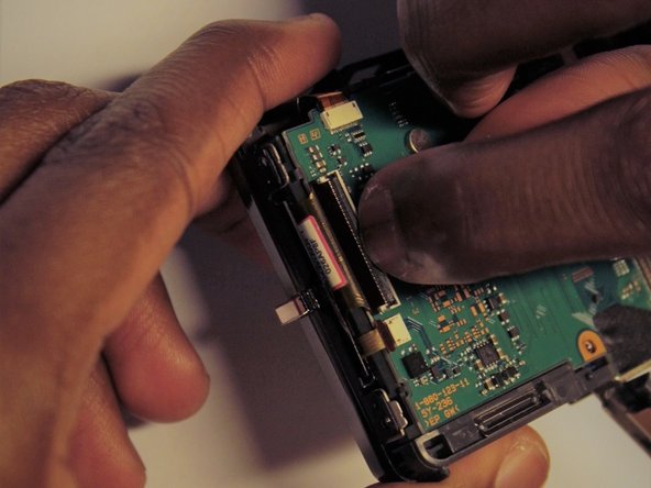

  4. Sony Cyber-Shot DSC-TX9 Flash Replacement: crwdns2935265:04crwdnd2935265:01crwdnd2935265:02crwdne2935265:0 Sony Cyber-Shot DSC-TX9 Flash Replacement: crwdns2935265:04crwdnd2935265:02crwdnd2935265:02crwdne2935265:0
    • The ZIF connector can be removed by flipping the small black holder into the upright position and then sliding the ribbon cable out carefully.
    • Once this has been done, use tweezers to unplug the flat topped connector for the lens’ circuit board from the motherboard.
    • DO NOT force the ribbon cables or they will rip.
    • Refer to the (Recognizing & Disconnecting Cable Connectors) page for assistance.

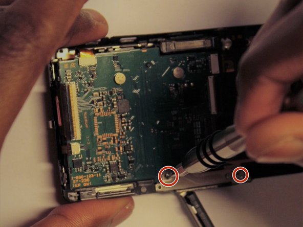

  5. Sony Cyber-Shot DSC-TX9 Flash Replacement, Flash: crwdns2935265:05crwdnd2935265:01crwdnd2935265:03crwdne2935265:0 Sony Cyber-Shot DSC-TX9 Flash Replacement, Flash: crwdns2935265:05crwdnd2935265:02crwdnd2935265:03crwdne2935265:0 Sony Cyber-Shot DSC-TX9 Flash Replacement, Flash: crwdns2935265:05crwdnd2935265:03crwdnd2935265:03crwdne2935265:0
    • Remove the two screws for the metal plate on the bottom.
    • Detach the no fuse ribbon cables by sliding them out.
    • Detach the ZIF connector cables by flipping the small black holder in an upright position and then sliding the cable out carefully.
    • Remove ribbons slowly and carefully or they WILL rip.
    • Screws are of Phillips type, head size Y0 and 0.3 mm in length.

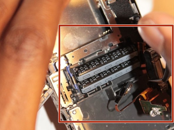

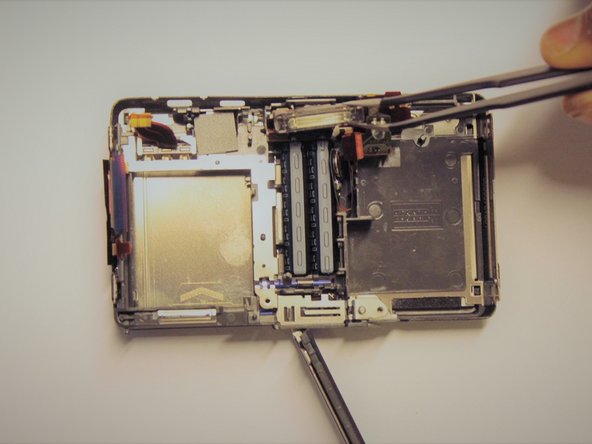

  6. Sony Cyber-Shot DSC-TX9 Flash Replacement: crwdns2935265:06crwdnd2935265:01crwdnd2935265:03crwdne2935265:0 Sony Cyber-Shot DSC-TX9 Flash Replacement: crwdns2935265:06crwdnd2935265:02crwdnd2935265:03crwdne2935265:0 Sony Cyber-Shot DSC-TX9 Flash Replacement: crwdns2935265:06crwdnd2935265:03crwdnd2935265:03crwdne2935265:0
    • Carefully remove the Memory card circuit board. You will then be able to see the flash with the capacitors connected.
    • Using tweezers, carefully remove the components. They are all connected together.
    • The circuit board should come out with little force. If it does not, make sure all connections are disconnected.
