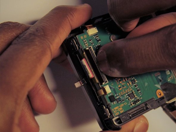

  4. Sony Cyber-Shot DSC-TX9 Card Reader Replacement: crwdns2935265:04crwdnd2935265:01crwdnd2935265:02crwdne2935265:0 Sony Cyber-Shot DSC-TX9 Card Reader Replacement: crwdns2935265:04crwdnd2935265:02crwdnd2935265:02crwdne2935265:0
    • The ZIF connector can be removed by flipping the small black holder into the upright position and then sliding the ribbon cable out carefully.
    • Once this has been done, use tweezers to unplug the flat topped connector for the lens’ circuit board from the motherboard.
    • DO NOT force the ribbon cables or they will rip.
    • Refer to the (Recognizing & Disconnecting Cable Connectors) page for assistance.

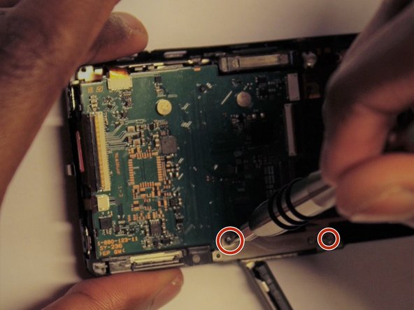

  5. Sony Cyber-Shot DSC-TX9 Card Reader Replacement, Card Reader: crwdns2935265:05crwdnd2935265:01crwdnd2935265:03crwdne2935265:0 Sony Cyber-Shot DSC-TX9 Card Reader Replacement, Card Reader: crwdns2935265:05crwdnd2935265:02crwdnd2935265:03crwdne2935265:0 Sony Cyber-Shot DSC-TX9 Card Reader Replacement, Card Reader: crwdns2935265:05crwdnd2935265:03crwdnd2935265:03crwdne2935265:0
    • Using a Phillips head screw driver, remove the two screws for the metal plate on the bottom.
    • Detach the smaller ribbon cables by sliding them out.
    • Detach the large ribbon cable by flipping the small black holder in an upright position and then sliding the cable out carefully.
    • Detach the ribbon cables slowly and carefully or they will rip.
  6. Sony Cyber-Shot DSC-TX9 Card Reader Replacement: crwdns2935265:06crwdnd2935265:01crwdnd2935265:02crwdne2935265:0 Sony Cyber-Shot DSC-TX9 Card Reader Replacement: crwdns2935265:06crwdnd2935265:02crwdnd2935265:02crwdne2935265:0
    • Carefully remove the Memory card circuit board.
    • The circuit board should come out with little force. If it does not, make sure all connections are disconnected.
