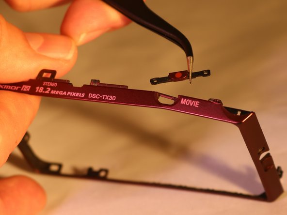

  15. Sony Cyber-Shot DSC-TX30 Movie Button Replacement, Movie Button: crwdns2935265:015crwdnd2935265:01crwdnd2935265:02crwdne2935265:0 Sony Cyber-Shot DSC-TX30 Movie Button Replacement, Movie Button: crwdns2935265:015crwdnd2935265:02crwdnd2935265:02crwdne2935265:0
    • Using the tweezers, remove the movie button from the back casing of the device.
