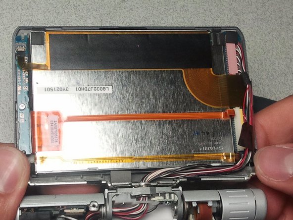

  3. Sony Clie PEG-UX50 Tilt Screen Replacement: crwdns2935265:03crwdnd2935265:01crwdnd2935265:02crwdne2935265:0 Sony Clie PEG-UX50 Tilt Screen Replacement: crwdns2935265:03crwdnd2935265:02crwdnd2935265:02crwdne2935265:0
    • Disconnect the thin USB cable attached to the Integrated Circuit.
  4. Sony Clie PEG-UX50 Tilt Screen Replacement: crwdns2935265:04crwdnd2935265:01crwdnd2935265:02crwdne2935265:0 Sony Clie PEG-UX50 Tilt Screen Replacement: crwdns2935265:04crwdnd2935265:02crwdnd2935265:02crwdne2935265:0
    • Detach the plastic black frame from in between the plate and the LCD.
    • Do not disconnect the display from the board yet.

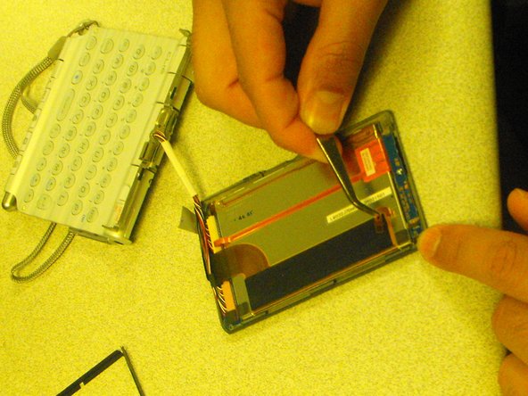

  5. Sony Clie PEG-UX50 Tilt Screen Replacement: crwdns2935265:05crwdnd2935265:01crwdnd2935265:01crwdne2935265:0
    • Disconnect the thin connector from the face plate using tweezers.
  6. Sony Clie PEG-UX50 Tilt Screen Replacement: crwdns2935265:06crwdnd2935265:01crwdnd2935265:01crwdne2935265:0
    • Quickly release and disconnect the thick cable with your hands.
