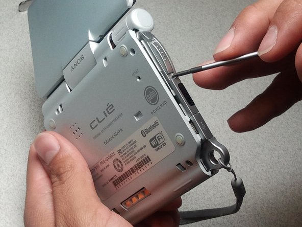

    • Use the Phillips #1 screwdriver to remove the four screws from the back of the rear cover.
    • Use the Phillips #1 screwdriver to remove the screw on the right side of the rear cover.
    • Use the Phillips #1 screwdriver to remove the screw on the top of the rear cover.
  2. Sony Clie PEG-UX50 Rear Case Replacement: crwdns2935265:02crwdnd2935265:01crwdnd2935265:02crwdne2935265:0 Sony Clie PEG-UX50 Rear Case Replacement: crwdns2935265:02crwdnd2935265:02crwdnd2935265:02crwdne2935265:0
    • Gently pry the rear cover case off to remove both the USB port cover and the hold switch.

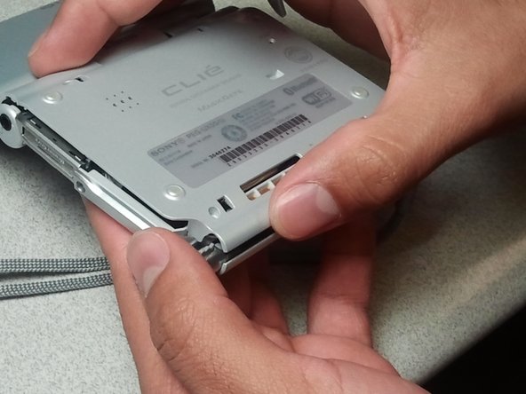

  3. Sony Clie PEG-UX50 Rear Case Replacement: crwdns2935265:03crwdnd2935265:01crwdnd2935265:02crwdne2935265:0 Sony Clie PEG-UX50 Rear Case Replacement: crwdns2935265:03crwdnd2935265:02crwdnd2935265:02crwdne2935265:0
    • Remove the side cover.
    • Slowly pull on the rear cover case to separate it from the rest of the device. The case should not come off completely.
    • To avoid wire breakage, do not pull hard on the speaker connection wire.
  4. Sony Clie PEG-UX50 Rear Case Replacement: crwdns2935265:04crwdnd2935265:01crwdnd2935265:01crwdne2935265:0
    • Gently remove the speaker wire from the device.
    • The rear cover case should now be completely separate from the device.
