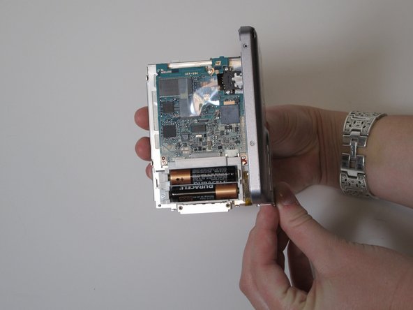

    • Remove the six screws holding the outside case of the Sony Clie.
  2. Sony Clie PEG-SL10 Battery Harness Replacement: crwdns2935265:02crwdnd2935265:01crwdnd2935265:01crwdne2935265:0
    • Remove the two screws holding the battery harness in place.
  3. Sony Clie PEG-SL10 Battery Harness Replacement: crwdns2935265:03crwdnd2935265:01crwdnd2935265:01crwdne2935265:0
    • Gently pull the power cable from the socket.
  4. Sony Clie PEG-SL10 Battery Harness Replacement: crwdns2935265:04crwdnd2935265:01crwdnd2935265:01crwdne2935265:0
    • The battery harness is now removed. Install the new harness in reverse order.
