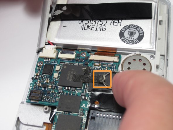

  4. Sony Clie PEG-NR70 Speaker Rail Replacement, Speaker Rail: crwdns2935265:04crwdnd2935265:01crwdnd2935265:02crwdne2935265:0 Sony Clie PEG-NR70 Speaker Rail Replacement, Speaker Rail: crwdns2935265:04crwdnd2935265:02crwdnd2935265:02crwdne2935265:0
    • Use tweezers to unplug the speaker wire from the motherboard by pulling the plug (not the wires) down towards the speaker.
    • Be careful not to tear the speaker wires! They are very thin.
    • Remove the tape holding speaker wire by peeling it away.
