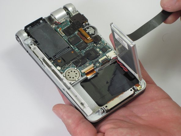

  4. Sony Clie PEG-NR70 Motherboard Replacement, Battery Pack: crwdns2935265:04crwdnd2935265:01crwdnd2935265:02crwdne2935265:0 Sony Clie PEG-NR70 Motherboard Replacement, Battery Pack: crwdns2935265:04crwdnd2935265:02crwdnd2935265:02crwdne2935265:0
    • Pull up on the black tab on the battery pack to reveal the power cord.
  5. Sony Clie PEG-NR70 Motherboard Replacement: crwdns2935265:05crwdnd2935265:01crwdnd2935265:01crwdne2935265:0
    • Disconnect the battery pack from the motherboard by unplugging the power cables. Gently pull the wire toward the bottom of the device.
    • Be careful to not tear the cables! They are very thin.
  6. Sony Clie PEG-NR70 Motherboard Replacement: crwdns2935265:06crwdnd2935265:01crwdnd2935265:01crwdne2935265:0
    • Gently peel back the adhesive to completely disconnect the battery pack from device.

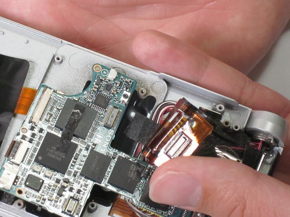

  15. Sony Clie PEG-NR70 Motherboard Replacement, Motherboard: crwdns2935265:015crwdnd2935265:01crwdnd2935265:01crwdne2935265:0
    • Unplug the ribbon cable found near the bottom of the motherboard by pulling it towards the bottom of the device.
    • Be careful not to tear the plug! It is very thin.
  16. Sony Clie PEG-NR70 Motherboard Replacement: crwdns2935265:016crwdnd2935265:01crwdnd2935265:02crwdne2935265:0 Sony Clie PEG-NR70 Motherboard Replacement: crwdns2935265:016crwdnd2935265:02crwdnd2935265:02crwdne2935265:0
    • Unplug the ribbon cable connected at the bottom of the memory module by prying it up with a spudger.
  17. Sony Clie PEG-NR70 Motherboard Replacement: crwdns2935265:017crwdnd2935265:01crwdnd2935265:01crwdne2935265:0
    • Unplug the wires found underneath the right side of the "stem" of the motherboard by pulling gently.
    • Be careful not to tear the wires! They are very thin.
  18. Sony Clie PEG-NR70 Motherboard Replacement: crwdns2935265:018crwdnd2935265:01crwdnd2935265:01crwdne2935265:0
    • Lift up the black locking tab holding the ribbon cable in place.
    • Gently pull on the ribbon cable to remove it from the ZIF connector.
    • Be careful not to tear the ribbon cable! It is very thin.
  19. Sony Clie PEG-NR70 Motherboard Replacement: crwdns2935265:019crwdnd2935265:01crwdnd2935265:01crwdne2935265:0
    • Unplug the yellow connector from the underside of the left side of the motherboard by pulling gently.
  20. Sony Clie PEG-NR70 Motherboard Replacement: crwdns2935265:020crwdnd2935265:01crwdnd2935265:01crwdne2935265:0
    • Unplug the second yellow connector from the underside of the right side of the motherboard by pulling gently.
  21. Sony Clie PEG-NR70 Motherboard Replacement: crwdns2935265:021crwdnd2935265:01crwdnd2935265:01crwdne2935265:0
    • Unplug the last set of wires from underneath the top of the motherboard.
    • The motherboard should be loose now. You should be able to wiggle it free from the housing.
