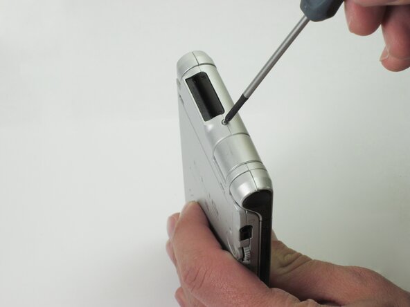

    • Unscrew the 1.9mm screw located at the top of the device with a Phillips #00 screwdriver.
    • It may be helpful to set up a piece of paper to keep track of where removed screws came from.

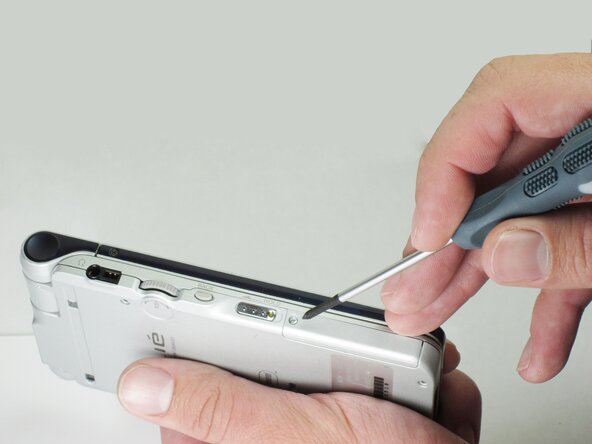

  2. Sony Clie PEG-NR70 Memory Module Replacement: crwdns2935265:02crwdnd2935265:01crwdnd2935265:01crwdne2935265:0
    • Unscrew the 2.5mm screw located on the left side of the device with a Phillips #00 screwdriver.

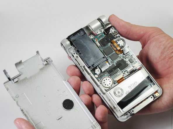

  3. Sony Clie PEG-NR70 Memory Module Replacement: crwdns2935265:03crwdnd2935265:01crwdnd2935265:02crwdne2935265:0 Sony Clie PEG-NR70 Memory Module Replacement: crwdns2935265:03crwdnd2935265:02crwdnd2935265:02crwdne2935265:0
    • Unscrew the five 2.5mm screws on the back panel with a Phillips #00 screwdriver.
    • Remove the back panel by lifting it away with your hands.
