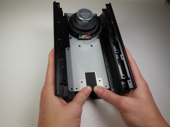

      • Remove eight 8 mm Phillips #2 screws holding the subwoofer tray to the housing.
    3. Sony CPF-IP001 Subwoofer Replacement: crwdns2935265:08crwdnd2935265:01crwdnd2935265:02crwdne2935265:0 Sony CPF-IP001 Subwoofer Replacement: crwdns2935265:08crwdnd2935265:02crwdnd2935265:02crwdne2935265:0
      • Using a metal spudger, slightly peel back the plastic the has been glued to the tray and the housing.
      • Slide the tray containing the subwoofer out of the housing.
    4. Sony CPF-IP001 Subwoofer Replacement: crwdns2935265:09crwdnd2935265:01crwdnd2935265:02crwdne2935265:0 Sony CPF-IP001 Subwoofer Replacement: crwdns2935265:09crwdnd2935265:02crwdnd2935265:02crwdne2935265:0

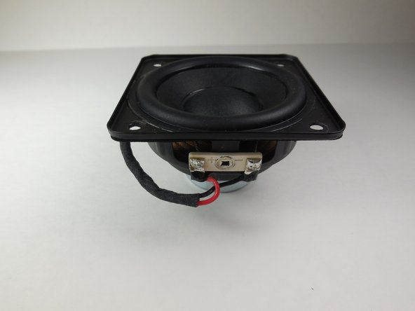

      • After removing the tray, flip it over and you will find four screws connecting the subwoofer.
      • Remove four 7.5 mm Phillips #2 screws.
    5. Sony CPF-IP001 Subwoofer Replacement: crwdns2935265:010crwdnd2935265:01crwdnd2935265:02crwdne2935265:0 Sony CPF-IP001 Subwoofer Replacement: crwdns2935265:010crwdnd2935265:02crwdnd2935265:02crwdne2935265:0
      • The subwoofer has now been removed from the device and can be replaced.
