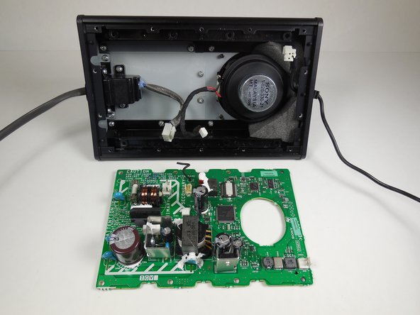

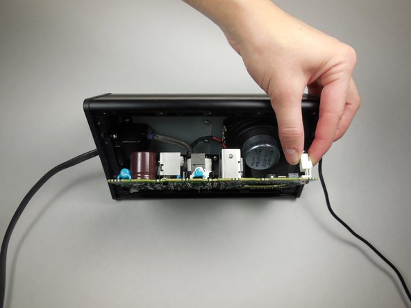

    • Once all of the screws are removed, the cover can be taken off using a metal spudger.
    • There are 8 more XXXX screws holding the circuit board in place that will need to be removed.
    • Once the screws are removed, a plastic spudger can be used to carefully move the circuit board away from the device.
    • There will be 3 wires connected to the opposite side of the circuit board. Be careful not to pull the board out of the device too far and damage these wires.

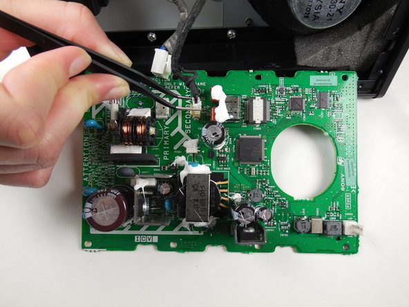

    • The first of the 3 wires can easily be found and is connected to the board via a clip.
    • To remove the clip squeeze the tap and pull it out.
    • There are still 2 more wires connected to the board. Now that the first has been removed the other two can be more easily reached.
  4. Sony CPF-IP001 Power Plug Replacement: crwdns2935265:04crwdnd2935265:01crwdnd2935265:03crwdne2935265:0 Sony CPF-IP001 Power Plug Replacement: crwdns2935265:04crwdnd2935265:02crwdnd2935265:03crwdne2935265:0 Sony CPF-IP001 Power Plug Replacement: crwdns2935265:04crwdnd2935265:03crwdnd2935265:03crwdne2935265:0
    • The wire furthest to the left of the device can be removed in the same way that he first was removed. Simply squeeze the clip and pull out.
    • The final wire (furthest to the right) can be carefully removed using a pair of tweezers.
    • Now the circuit board has been completely removed from the device and can be set aside.

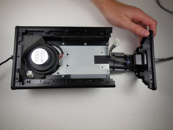

    • Remove these next 6 XXXX screws using a Phillips #2 screwdriver.
    • The housing is now disconnected from the device and can be pulled out from the side.
    • The power housing will come out as a whole unit with the subwoofer air tunnel.

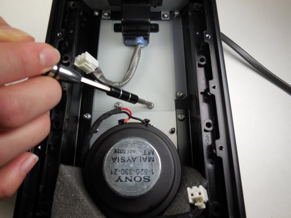

  7. Sony CPF-IP001 Power Plug Replacement: crwdns2935265:07crwdnd2935265:01crwdnd2935265:01crwdne2935265:0
    • The subwoofer air tunnel can be removed by unscrewing the 2 XXXX screws with a Phillips #2 screwdriver.
