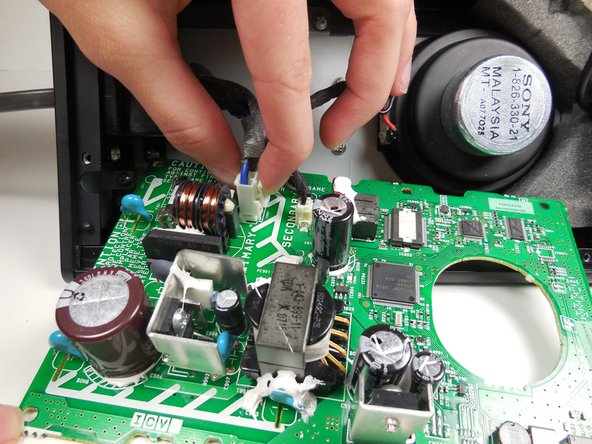

    3. Sony CPF-IP001 Power Cord Replacement: crwdns2935265:03crwdnd2935265:01crwdnd2935265:02crwdne2935265:0 Sony CPF-IP001 Power Cord Replacement: crwdns2935265:03crwdnd2935265:02crwdnd2935265:02crwdne2935265:0
      • Remove the first of the three wires by squeezing the clip and pulling it out.
      • After disconnecting the first wire, the two attached wires can be more easily accessed.

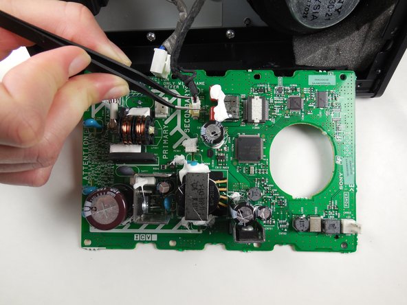

    4. Sony CPF-IP001 Power Cord Replacement: crwdns2935265:04crwdnd2935265:01crwdnd2935265:03crwdne2935265:0 Sony CPF-IP001 Power Cord Replacement: crwdns2935265:04crwdnd2935265:02crwdnd2935265:03crwdne2935265:0 Sony CPF-IP001 Power Cord Replacement: crwdns2935265:04crwdnd2935265:03crwdnd2935265:03crwdne2935265:0
      • Remove the wire furthest to the left by squeezing the clip and pulling it out.
      • Detach the third wire by carefully using the tweezers.
      • The circuit board is now completely detached and can be set aside.

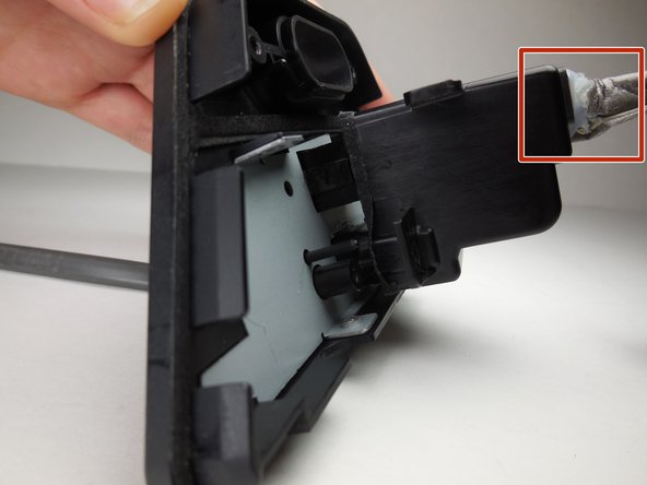

    2. Sony CPF-IP001 Power Cord Replacement: crwdns2935265:07crwdnd2935265:01crwdnd2935265:02crwdne2935265:0 Sony CPF-IP001 Power Cord Replacement: crwdns2935265:07crwdnd2935265:02crwdnd2935265:02crwdne2935265:0
      • Begin to pry the power cord cover unit from the side panel using a metal spudger.
      • Feed the wires that come out of the side panel through the glue and into the power cord cover unit to get the cover farther away from the side panel.

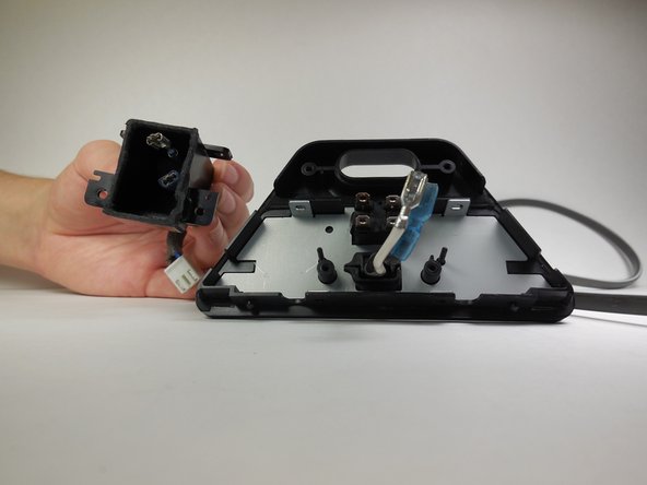

    3. Sony CPF-IP001 Power Cord Replacement: crwdns2935265:08crwdnd2935265:01crwdnd2935265:02crwdne2935265:0 Sony CPF-IP001 Power Cord Replacement: crwdns2935265:08crwdnd2935265:02crwdnd2935265:02crwdne2935265:0
      • Using a metal spudger, disconnect the four spade connectors that are connected to the power button and the power cord.
    4. Sony CPF-IP001 Power Cord Replacement: crwdns2935265:09crwdnd2935265:01crwdnd2935265:02crwdne2935265:0 Sony CPF-IP001 Power Cord Replacement: crwdns2935265:09crwdnd2935265:02crwdnd2935265:02crwdne2935265:0
      • Using a metal spudger, press the tab on top of the power cord and push the power cord through the side panel.
      • Once through, the clip connected to the power cord will open up and a new power cord can be put in place.
