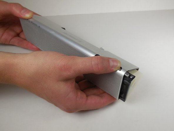

  1. Sony CPF-IP001 Main Speakers Replacement, Main Speaker Housing Disassembly: crwdns2935265:01crwdnd2935265:01crwdnd2935265:01crwdne2935265:0
    • Remove two 6mm Phillips #0 screws.
    • Remove two 7.5 mm Phillips #0 screws.
    • Remove seven 4 mm Phillips #0 screws.
  2. Sony CPF-IP001 Main Speakers Replacement: crwdns2935265:02crwdnd2935265:01crwdnd2935265:03crwdne2935265:0 Sony CPF-IP001 Main Speakers Replacement: crwdns2935265:02crwdnd2935265:02crwdnd2935265:03crwdne2935265:0 Sony CPF-IP001 Main Speakers Replacement: crwdns2935265:02crwdnd2935265:03crwdnd2935265:03crwdne2935265:0

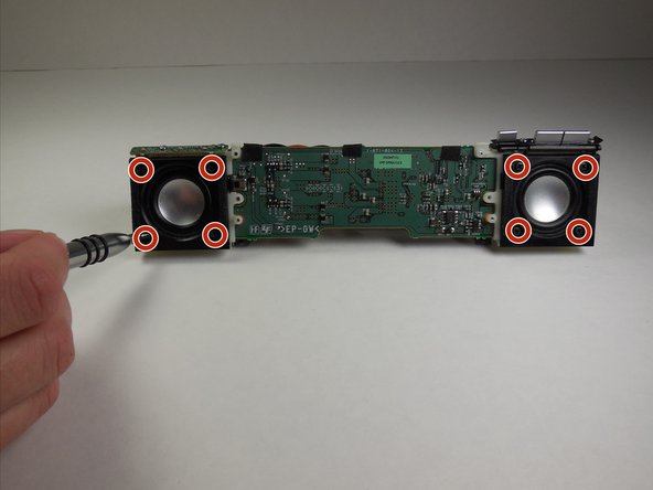

    • Remove six 4 mm Phillips #0 screws from the metal backing.
    • Remove six 5 mm Phillips #0 screws from the metal backing.
    • Using the plastic opening tool, remove the metal plate from the main speaker by gently pulling on it.

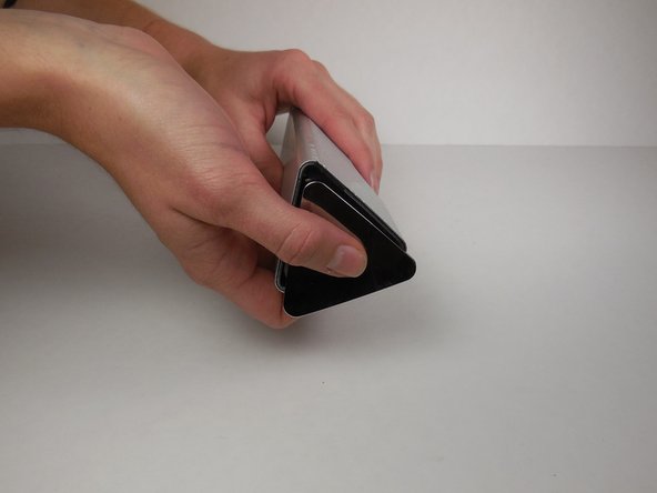

  3. Sony CPF-IP001 Main Speakers Replacement: crwdns2935265:03crwdnd2935265:01crwdnd2935265:02crwdne2935265:0 Sony CPF-IP001 Main Speakers Replacement: crwdns2935265:03crwdnd2935265:02crwdnd2935265:02crwdne2935265:0
    • Remove the plastic dock cover by using two fingers to push the attached metal piece forward and slide it out of the holes.

  7. Sony CPF-IP001 Main Speakers Replacement, Main Speakers: crwdns2935265:07crwdnd2935265:01crwdnd2935265:02crwdne2935265:0 Sony CPF-IP001 Main Speakers Replacement, Main Speakers: crwdns2935265:07crwdnd2935265:02crwdnd2935265:02crwdne2935265:0
    • Remove eight 5 mm Phillips #0 screws.
  8. Sony CPF-IP001 Main Speakers Replacement: crwdns2935265:08crwdnd2935265:01crwdnd2935265:02crwdne2935265:0 Sony CPF-IP001 Main Speakers Replacement: crwdns2935265:08crwdnd2935265:02crwdnd2935265:02crwdne2935265:0
    • Gently pry the speaker out from the housing using the metal spudger.
    • Use wire cutters to cut the red and black wires, or desolder the speaker wires to remove the speaker. See iFixit's guide on How To Solder and Desolder Connections.
