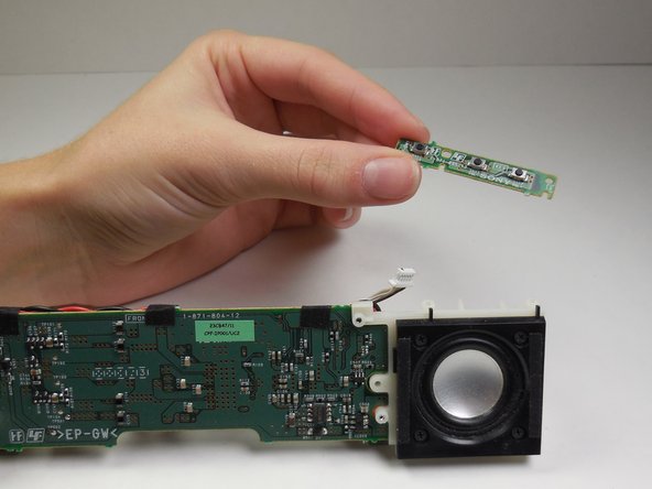

  7. Sony CPF-IP001 Buttons on Main Speaker Replacement, Buttons on Main Speaker: crwdns2935265:07crwdnd2935265:01crwdnd2935265:03crwdne2935265:0 Sony CPF-IP001 Buttons on Main Speaker Replacement, Buttons on Main Speaker: crwdns2935265:07crwdnd2935265:02crwdnd2935265:03crwdne2935265:0 Sony CPF-IP001 Buttons on Main Speaker Replacement, Buttons on Main Speaker: crwdns2935265:07crwdnd2935265:03crwdnd2935265:03crwdne2935265:0
    • Remove two 6 mm Phillips #0 screws.
    • Gently lift the silver buttons up to remove.

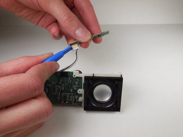

  8. Sony CPF-IP001 Buttons on Main Speaker Replacement: crwdns2935265:08crwdnd2935265:01crwdnd2935265:03crwdne2935265:0 Sony CPF-IP001 Buttons on Main Speaker Replacement: crwdns2935265:08crwdnd2935265:02crwdnd2935265:03crwdne2935265:0 Sony CPF-IP001 Buttons on Main Speaker Replacement: crwdns2935265:08crwdnd2935265:03crwdnd2935265:03crwdne2935265:0
    • Using the plastic opening tool, disconnect the white connector from the circuit board.
    • Replace the broken circuit board with a new one.
