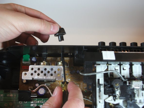

  7. Sony CFS-204 Radio Cassette-Corder Volume Knob Replacement, Volume or Tone Knob: crwdns2935265:07crwdnd2935265:01crwdnd2935265:02crwdne2935265:0 Sony CFS-204 Radio Cassette-Corder Volume Knob Replacement, Volume or Tone Knob: crwdns2935265:07crwdnd2935265:02crwdnd2935265:02crwdne2935265:0
    • Push upwards against bottom edge of the knob connection with a flat head screwdriver until the knob pops off.
    • You may wish to hold on to the knob so you don't lose it!
