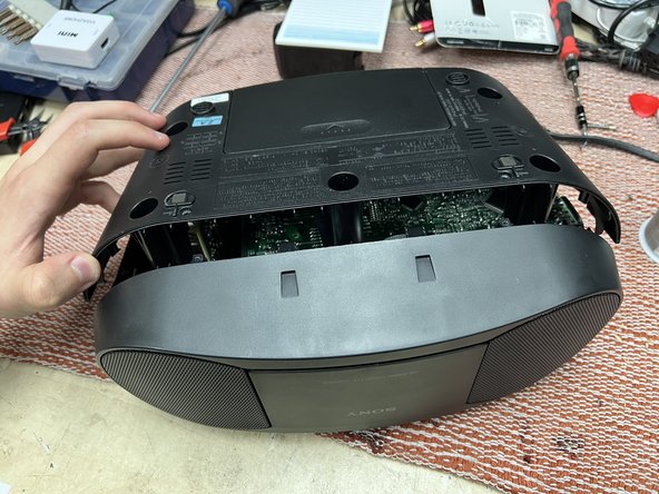

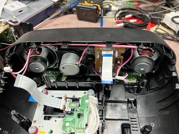

  3. Sony CFD-S70 Disassembly, Opening the device: crwdns2935265:03crwdnd2935265:01crwdnd2935265:02crwdne2935265:0 Sony CFD-S70 Disassembly, Opening the device: crwdns2935265:03crwdnd2935265:02crwdnd2935265:02crwdne2935265:0
    • Turn the device on his back and pull back and up the bottom portion of the device
    • There’s a connector attached, be careful

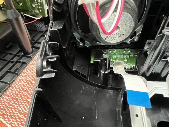

  4. Sony CFD-S70 Disassembly, Removing a cable: crwdns2935265:04crwdnd2935265:01crwdnd2935265:01crwdne2935265:0
    • Be careful, the connector is fragile

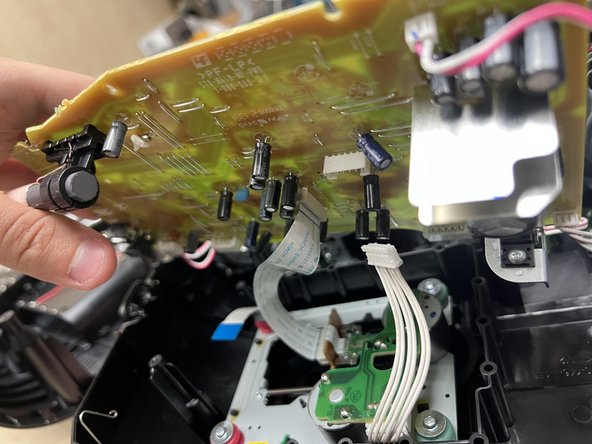

  5. Sony CFD-S70 Disassembly, Removing and unplugging the main: crwdns2935265:05crwdnd2935265:01crwdnd2935265:03crwdne2935265:0 Sony CFD-S70 Disassembly, Removing and unplugging the main: crwdns2935265:05crwdnd2935265:02crwdnd2935265:03crwdne2935265:0 Sony CFD-S70 Disassembly, Removing and unplugging the main: crwdns2935265:05crwdnd2935265:03crwdnd2935265:03crwdne2935265:0
    • Remove the two screws with a PH2
    • Remove the connector on the left side of the mainboard
    • Stress the right side where there’s the audio connections and pull the main by the left

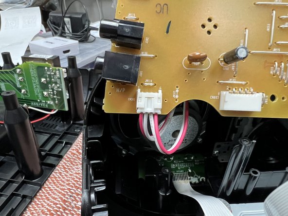

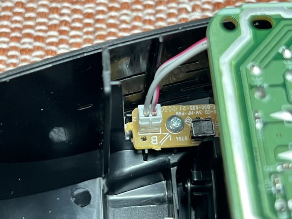

  6. Sony CFD-S70 Disassembly, Disconnecting connectors: crwdns2935265:06crwdnd2935265:01crwdnd2935265:02crwdne2935265:0 Sony CFD-S70 Disassembly, Disconnecting connectors: crwdns2935265:06crwdnd2935265:02crwdnd2935265:02crwdne2935265:0
    • On the bottom of the main, gently disconnect the connector
    • This connector is VERY fragile. Use something to hold it in place
    • Like the connector, remove the Flex cable from the main
    • Also use caution while removing it. It can break/cut very easily

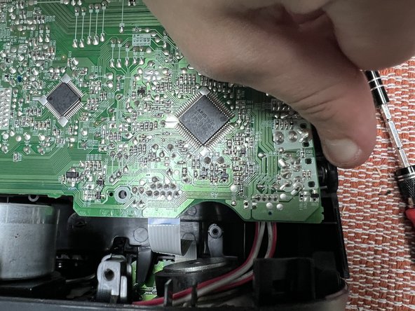

  7. Sony CFD-S70 Disassembly, Disconnecting connectors: crwdns2935265:07crwdnd2935265:01crwdnd2935265:03crwdne2935265:0 Sony CFD-S70 Disassembly, Disconnecting connectors: crwdns2935265:07crwdnd2935265:02crwdnd2935265:03crwdne2935265:0 Sony CFD-S70 Disassembly, Disconnecting connectors: crwdns2935265:07crwdnd2935265:03crwdnd2935265:03crwdne2935265:0
    • Carefully flip the main and disconnect like the others the cables. You can now remove the mainboard
    • Like before, they’re very fragile
  8. Sony CFD-S70 Disassembly, Removing the front: crwdns2935265:08crwdnd2935265:01crwdnd2935265:02crwdne2935265:0 Sony CFD-S70 Disassembly, Removing the front: crwdns2935265:08crwdnd2935265:02crwdnd2935265:02crwdne2935265:0

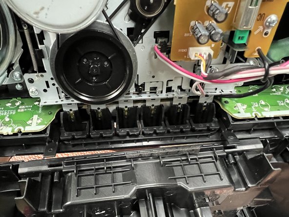

    • Now it’s time to remove the front of the device. There’s two little brackets on each side that is retaining the front
  9. Sony CFD-S70 Disassembly, Pulling the front tabs: crwdns2935265:09crwdnd2935265:01crwdnd2935265:02crwdne2935265:0 Sony CFD-S70 Disassembly, Pulling the front tabs: crwdns2935265:09crwdnd2935265:02crwdnd2935265:02crwdne2935265:0
    • Using a flat screwdriver or any other flat and thin tool, pry the outside tabs working your way down and pull the front from the top of the device
    • There’s two little tabs with screw holes. Be careful not to damage them
