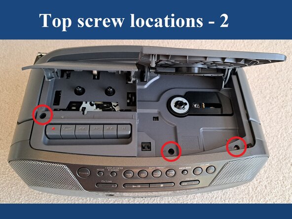

  2. Sony CFD-S07CP: CD and Tape mechanisms, Top screws: crwdns2935265:02crwdnd2935265:01crwdnd2935265:02crwdne2935265:0 Sony CFD-S07CP: CD and Tape mechanisms, Top screws: crwdns2935265:02crwdnd2935265:02crwdnd2935265:02crwdne2935265:0
    • Set the boombox upright.
    • Lift up the carrying handle and move the FM telescoping antenna out of the way.
    • There are six Philips head screws to remove from under the handle, circled in red.
    • Push the handle down, then open the CD and cassette tape compartments. There are three more Philips head screws to remove, circled in red.

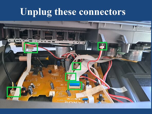

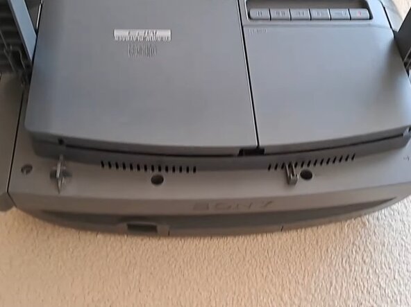

  3. Sony CFD-S07CP: CD and Tape mechanisms, Removing the top shell: crwdns2935265:03crwdnd2935265:01crwdnd2935265:03crwdne2935265:0 Sony CFD-S07CP: CD and Tape mechanisms, Removing the top shell: crwdns2935265:03crwdnd2935265:02crwdnd2935265:03crwdne2935265:0 Sony CFD-S07CP: CD and Tape mechanisms, Removing the top shell: crwdns2935265:03crwdnd2935265:03crwdnd2935265:03crwdne2935265:0
    • Close the CD and cassette tape doors, then lift up the carrying handle.
    • Gently pry up from behind, just below the 'SONY' logo at the rear.
    • Be careful not to tug too hard on the top shell, as there are six connectors you will need to disconnect.

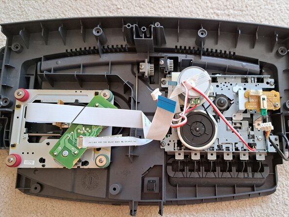

  4. Sony CFD-S07CP: CD and Tape mechanisms, Service CD and/or tape deck: crwdns2935265:04crwdnd2935265:01crwdnd2935265:01crwdne2935265:0
    • With the top shell separated from the rest of the unit, there is ample room to replace or service the CD and/or tape mechanisms.
