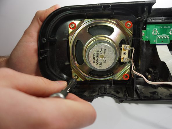

  4. Sony CFD-8 Speaker Replacement, Speaker: crwdns2935265:04crwdnd2935265:01crwdnd2935265:02crwdne2935265:0 Sony CFD-8 Speaker Replacement, Speaker: crwdns2935265:04crwdnd2935265:02crwdnd2935265:02crwdne2935265:0
    • Use a 14cm Phillips #1 screwdriver to remove the four respective screws attaching the left and right speakers to the front panel.
  5. Sony CFD-8 Speaker Replacement: crwdns2935265:05crwdnd2935265:01crwdnd2935265:01crwdne2935265:0
    • Remove the speakers from the front panel.
