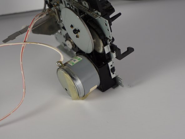

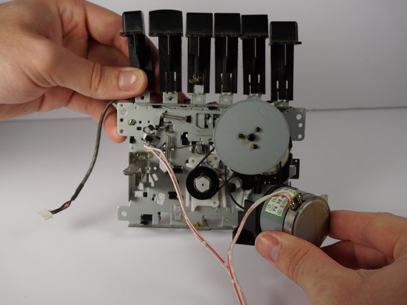

  8. Sony CFD-8 Motor Belt Replacement, Remove Motor: crwdns2935265:08crwdnd2935265:01crwdnd2935265:03crwdne2935265:0 Sony CFD-8 Motor Belt Replacement, Remove Motor: crwdns2935265:08crwdnd2935265:02crwdnd2935265:03crwdne2935265:0 Sony CFD-8 Motor Belt Replacement, Remove Motor: crwdns2935265:08crwdnd2935265:03crwdnd2935265:03crwdne2935265:0
    • Unscrew the 5mm screw shown in the photo.
    • Note the small latch on the side of assembly as you remove the motor.

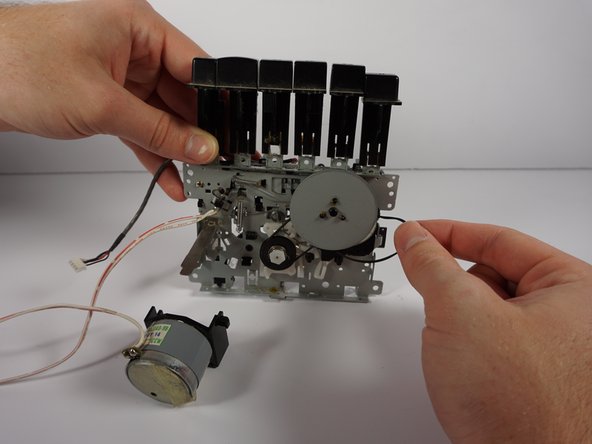

  9. Sony CFD-8 Motor Belt Replacement, Replace Motor Belt: crwdns2935265:09crwdnd2935265:01crwdnd2935265:02crwdne2935265:0 Sony CFD-8 Motor Belt Replacement, Replace Motor Belt: crwdns2935265:09crwdnd2935265:02crwdnd2935265:02crwdne2935265:0
    • Remove the motor belt from its axle.

Here's some information about the belts needed, which may be especially useful if your old belts have turned to goo like mine! Two identical belts are needed: the Sony part number is 3-362-989-01, and generic names appear to include SBO5.2 and SCY5.2. It's a square belt with 1 mm thickness and an inside diameter of 5.2 inches. I found that the most economical way to purchase these was to get a bulk bag of 1 mm square belts of mixed length.
