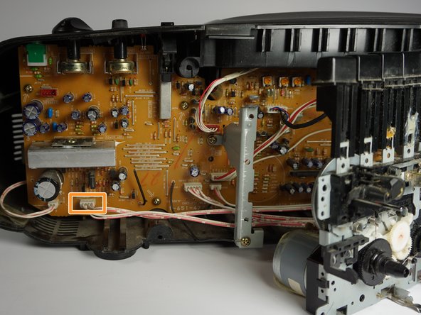

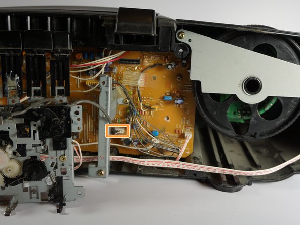

  5. Sony CFD-8 Main Circuit Board Replacement: crwdns2935265:05crwdnd2935265:01crwdnd2935265:03crwdne2935265:0 Sony CFD-8 Main Circuit Board Replacement: crwdns2935265:05crwdnd2935265:02crwdnd2935265:03crwdne2935265:0 Sony CFD-8 Main Circuit Board Replacement: crwdns2935265:05crwdnd2935265:03crwdnd2935265:03crwdne2935265:0
    • Gently separate the front panel from the back panel.
    • Remove the two connections holding the front panel to boombox.
    • One connection is located on the upper left hand side of the main circuit board.
    • The other is a large white strip slightly to the right of the cassette player.
    • Do not touch the cylindrical parts on the circuit board. These are capacitors and may deliver a shock!
    • Remove the front panel.

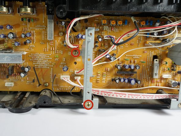

  7. Sony CFD-8 Main Circuit Board Replacement: crwdns2935265:07crwdnd2935265:01crwdnd2935265:03crwdne2935265:0 Sony CFD-8 Main Circuit Board Replacement: crwdns2935265:07crwdnd2935265:02crwdnd2935265:03crwdne2935265:0 Sony CFD-8 Main Circuit Board Replacement: crwdns2935265:07crwdnd2935265:03crwdnd2935265:03crwdne2935265:0
    • Use a Phillips #1 screwdriver to unscrew the four 12 mm screws that connect the brackets to the main circuit board.
    • Gently pull the brackets outwards to remove them.

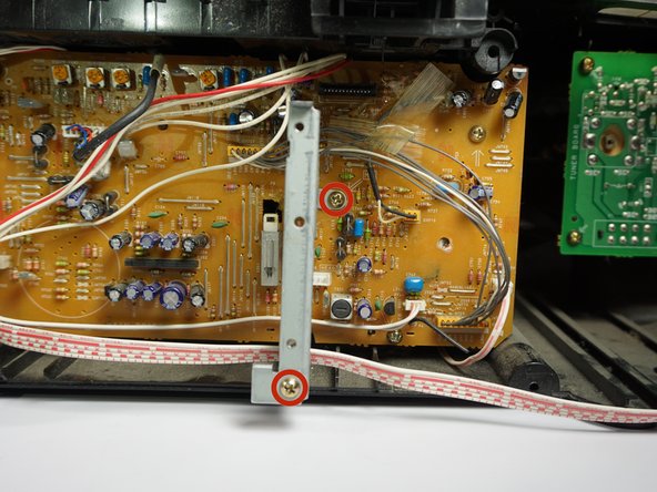

  8. Sony CFD-8 Main Circuit Board Replacement: crwdns2935265:08crwdnd2935265:01crwdnd2935265:01crwdne2935265:0
    • Use a Phillips #1 screwdriver to unscrew the 10 mm screw located on the top left of the tuner wheel bracket. Remove the metal bracket.

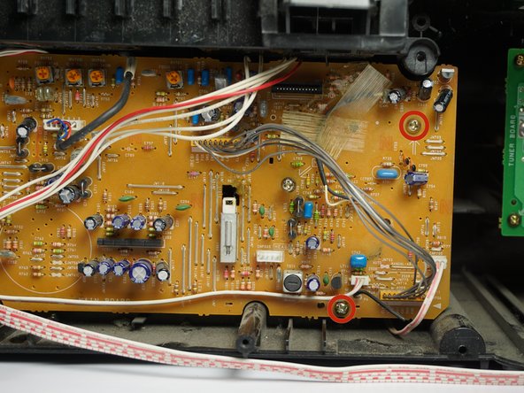

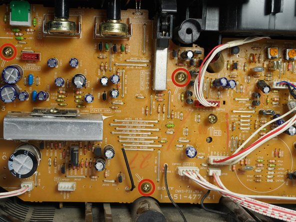

  10. Sony CFD-8 Main Circuit Board Replacement: crwdns2935265:010crwdnd2935265:01crwdnd2935265:03crwdne2935265:0 Sony CFD-8 Main Circuit Board Replacement: crwdns2935265:010crwdnd2935265:02crwdnd2935265:03crwdne2935265:0 Sony CFD-8 Main Circuit Board Replacement: crwdns2935265:010crwdnd2935265:03crwdnd2935265:03crwdne2935265:0
    • Use a Phillips #1 screwdriver to unscrew the five 10 mm screws located on the main circuit board.
    • Note that the second picture depicts the left half of the main circuit board. The third picture contains the right half.

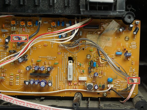

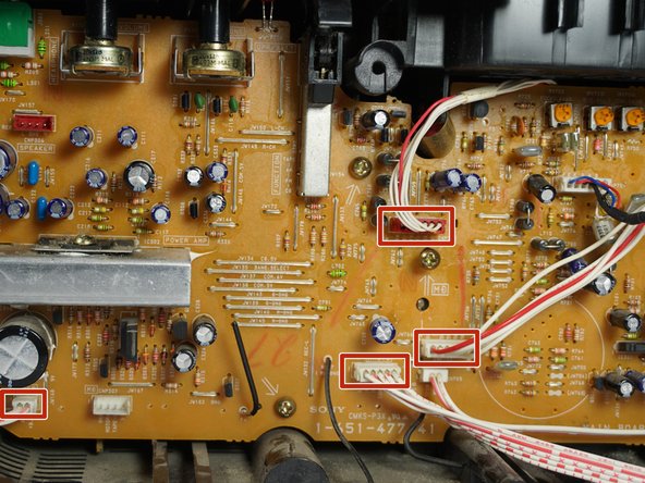

  11. Sony CFD-8 Main Circuit Board Replacement: crwdns2935265:011crwdnd2935265:01crwdnd2935265:03crwdne2935265:0 Sony CFD-8 Main Circuit Board Replacement: crwdns2935265:011crwdnd2935265:02crwdnd2935265:03crwdne2935265:0 Sony CFD-8 Main Circuit Board Replacement: crwdns2935265:011crwdnd2935265:03crwdnd2935265:03crwdne2935265:0
    • Disconnect the six wire sets that connect to the main circuit board as shown. Each of the wires have 3-6 prongs.
    • The order of removal is not important.
    • The connections for each of these wire sets is a different size. When reassembling, use these size differences to determine how the wire sets reconnect to the circuit board.

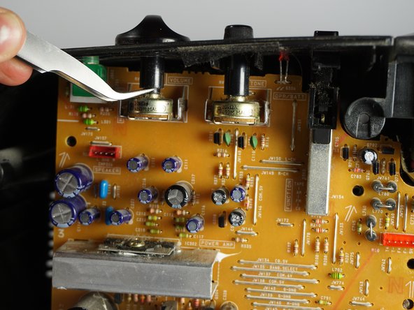

  12. Sony CFD-8 Main Circuit Board Replacement: crwdns2935265:012crwdnd2935265:01crwdnd2935265:02crwdne2935265:0 Sony CFD-8 Main Circuit Board Replacement: crwdns2935265:012crwdnd2935265:02crwdnd2935265:02crwdne2935265:0
    • Use a pair of tweezers to pry off the volume and tuner buttons located on the top left of the boombox.
    • Pry the buttons off by placing the tweezers under each button as shown in the first picture. Proceed to push gently upwards until the button pops off.
