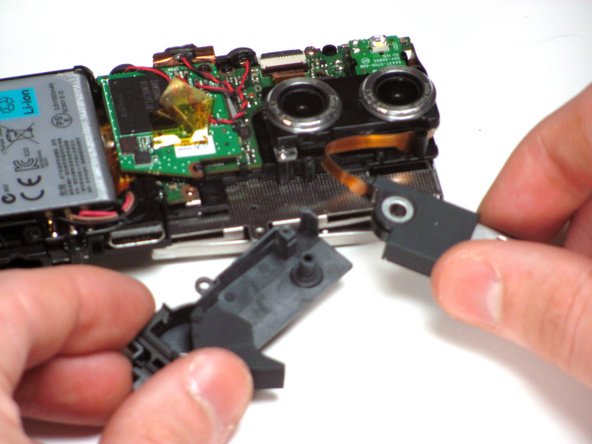

    • Using your hand, or a pair of tweezers, remove the ZIF connector by gently pulling it out of the dock on the circuit board.
  4. Sony Bloggie 3D Player USB Drive Replacement: crwdns2935265:04crwdnd2935265:01crwdnd2935265:02crwdne2935265:0 Sony Bloggie 3D Player USB Drive Replacement: crwdns2935265:04crwdnd2935265:02crwdnd2935265:02crwdne2935265:0
    • Use a plastic opening tool to loosen the back cover off the device.
    • Once the back cover is loose, remove it gently by hand.
  5. Sony Bloggie 3D Player USB Drive Replacement, USB Drive: crwdns2935265:05crwdnd2935265:01crwdnd2935265:02crwdne2935265:0 Sony Bloggie 3D Player USB Drive Replacement, USB Drive: crwdns2935265:05crwdnd2935265:02crwdnd2935265:02crwdne2935265:0
    • Once the back cover is removed, by using the opening tool, remove the following screws using a Phillips #00 screwdriver.
    • Two 4.0mm Phillips #00 screws
    • One 8.0mm Phillips #00 screw
    • One 9.5mm Phillips #00 screw
  6. Sony Bloggie 3D Player USB Drive Replacement: crwdns2935265:06crwdnd2935265:01crwdnd2935265:02crwdne2935265:0 Sony Bloggie 3D Player USB Drive Replacement: crwdns2935265:06crwdnd2935265:02crwdnd2935265:02crwdne2935265:0
    • Using a spudger, remove the clips of the metal casing from each end of the USB drive.
  7. Sony Bloggie 3D Player USB Drive Replacement: crwdns2935265:07crwdnd2935265:01crwdnd2935265:02crwdne2935265:0 Sony Bloggie 3D Player USB Drive Replacement: crwdns2935265:07crwdnd2935265:02crwdnd2935265:02crwdne2935265:0
    • Carefully lift the USB drive off of the peg that it is attached to.
  8. Sony Bloggie 3D Player USB Drive Replacement: crwdns2935265:08crwdnd2935265:01crwdnd2935265:01crwdne2935265:0
    • Now that the USB component is on its own, untangle the ribbon from inside the device.
  9. Sony Bloggie 3D Player USB Drive Replacement: crwdns2935265:09crwdnd2935265:01crwdnd2935265:01crwdne2935265:0
    • Now remove the ZIF connector from the device using a pair of tweezers.
